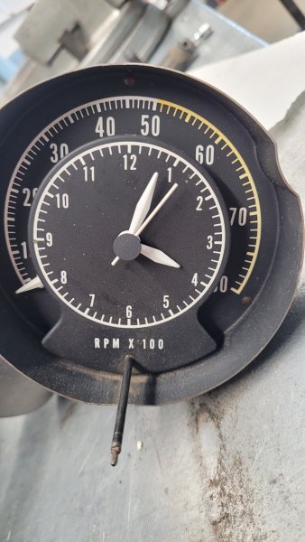

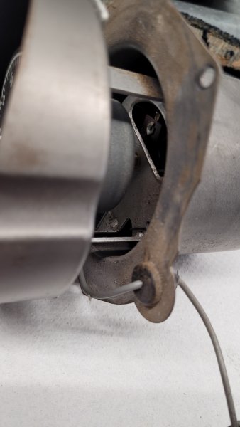

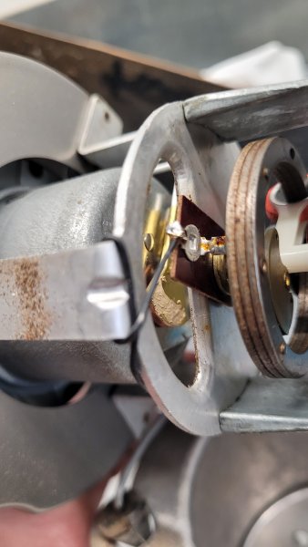

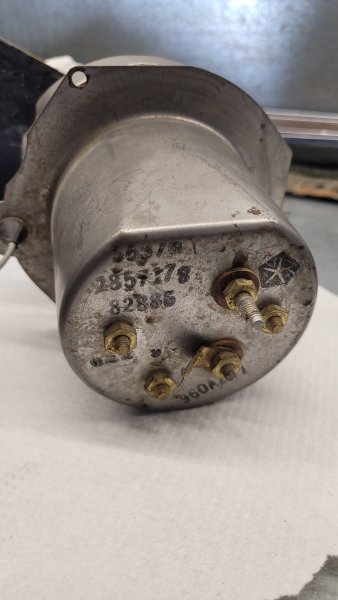

So I have a tick tock tach out of a '69 Coronet that reads double what it's supposed to. I cracked it open and can't find anything obviously wrong. Any help would be appreciated.

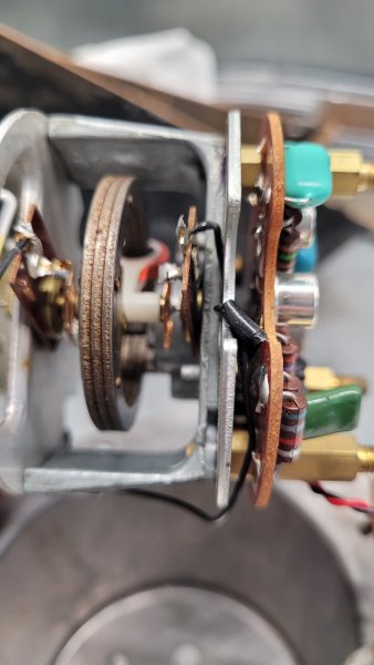

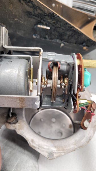

I see what looks to be a potentiometer on the board. That cause me to search for "tachometer adjust potentiometer". This is the first article that came up for me but looks like there are a bunch more. I don't know anything about these though so tread carefully.
[/URL][/URL]
It appears as if most (all) of the origional parts have been up graded, including the calibration potentiometer. I believe the tachis is RMS reading volt meter and the circuitry measures the pulses the coil receives translated into RPM. Your best bet is to replace the entire board assembly with the RTE board....it's an exact fit....follow the instructions.....end of problem......just my opinion.....

The circuit is a two transistor integrator with some hysteresis. I would bet that replacement of all capacitors would restore operation, but the RTE upgrade has a two point built in calibrator, and works with points, or even MSD, plus other electronic ignition.
