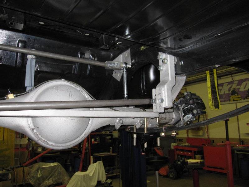

I just purchased the summit front and rear bars and they are nice. The front took about an hour to bolt up and the rear is going to take a little longer due to having to move some lines for clearance on the axle. The rear bar is also adjustable so you can stiffen it up more if needed.

My panhard bar. And the drag race antisway bar I'm going to use on the street.
Did you buy this rear one? https://www.summitracing.com/int/parts/sum-720231/overview/year/1969/make/dodge/model/coronet
How does that install, i think i've seen different ways but which side connects to the axle?
Both ends on the axle or the ends on the chassis?
The length of the bar connects via ubolts and bracket to the axle. There are 2 end-links that connect to the frame rails ahead of the axle. in the link you provided is the instruction sheet via pdf that is fairly detailed.
