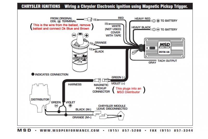

That is what I did. I used the Electronic Ignition conversion kit, and then added the 6AL box. Do not delete the connector for the Chrysler Orange box, as you can carry it and use it if you have issues.

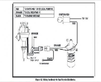

Can anyone go into any more details on what is needed to be done to the cars wireing ,whats getting removed whats staying . I am thinking about going the full msd setup on my 340 also and a bit more info would be helpful for everyone.
Thanks
Any pics would be nice too.
The MSD setup is simple. You have a few connections that are self-contained like to the MSD Distributor, and an MSD coil. You just need an ignition source: I removed the ballast and connected the Dk. Blue and Brown wires together (run/start).
The ballast is just to lower the voltage on a points setup - the Brown wire provided a full 12 volts to the coil for starting (IG2), and the Dk Blue wire went to the opposite side of the ballast to reduced voltage in run (IG1).
This is how I've had mine connected for a while, and it works great. Just remember: the "Ready to Run" distributor has the built-in ignition and doesn't require an ignition box, but I prefer to have the 6AL and a standard MSD distributor.
Not sure how others have set theirs up.

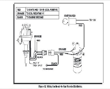

If you want clean and simple, look at the MSD ready to run. I've had one in my small block bracket car (11.70's, shifting at 6500 rpm's) for 8 years with no issues. It's cheaper than the box & distributor system and has served me well. No box, no resistor, you can go with vacuum or mechanical advance. You can also easily change the advance curve.

Did you also connect the dk blue and brown wires together to get 12V during crank and run? I've heard a couple people say there can be problems, but I don't see why... they both went to 12 volts, one (run) just ended up on one side of a ballast resistor.
Yes, I just bypassed the ballast resistor altogether. When I bought the distributor I called MSD to make sure because I had the same concerns but they assured me I didn't need it anymore. No problems. Wire it just like the diagram.
Thanks, I know that the ballast isn't needed, but I was wondering if you connected the two wires? One is only crank, the other is only run - when I did this I was told I needed to use a diode, but never did.
Using a diode is an interesting concept. I wonder where they got that idea. A diode blocks the directional of flow for DC current but the original resistor does not. It only adds resistance to the current flow. I'm no electrical engineer but it seems like apples & oranges.
I always thought that ballast resistors and condensers were used to keep points from burning up. Maybe someone that really knows this stuff can chime in.
I think the Mopar system puts full voltage when starting (hotter spark) start and backs off at run. Bypass the resistor, blow your ignition box in a few hours of driving. I learned that the hard way.
Yes, the Mopar system provided 12v at crank and during run the power to the coil went through the resistor, which knocked it down to about 9 volts. It was to save the points, but when you go to an aftermarket dist and ign, you don't need less than 12 volts. I just wondered about the diode recommendation because, technically, those two wires connect to the same point... just one circuit at a time and it's for reduced voltage. As I stated, I just connect both wires together to provide power to my ignition box and the EFI computer and in over a year no issues. Thanks
