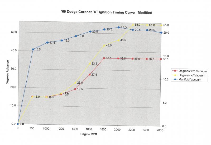

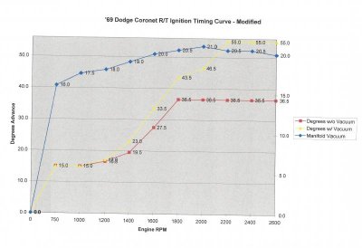

Sample of how one of mine is setup
That curve looks interesting... all in @ 1800 rpm...?? I ve read about this fast curve in a JENSEN Forum , while I was searching for the "Right Curve " for my 440 HP Engine from 1969.... The Jensen guys in England use a similar curve... around 10-12 deg @ idle...
and 36 deg @ 1800 -1900 rpm.... plus the vacuum advance..
I am thinking to chance my curve to this setup...also, but I have some fear, because the curve is so ...."agressive "... doesn´t that hurt the main and rod bearings while accelerating ?
