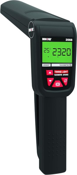

I have this one, works well: Innova 5568 - Innova Pro Timing Lights
Innova 5568 Innova Pro Timing Lights | Summit Racing

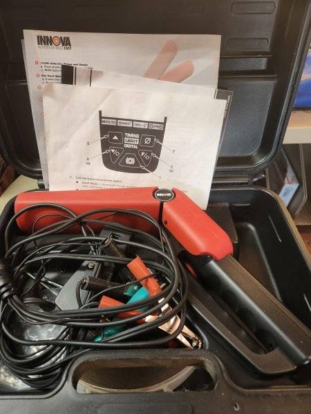

Ditto - bought this one couple years ago and naturally a few buddies have borrowed it...ya know, why buy one when a bud has one. No complaints with it.
