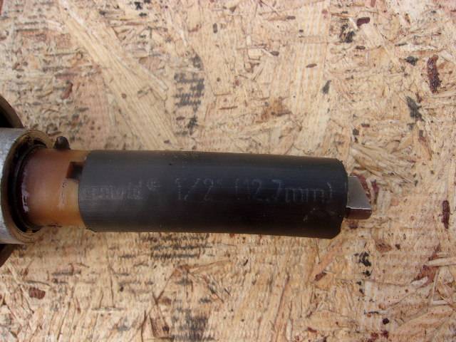

Here you go.
Doug
From previous posts;
Different collar, This one goes at the bottom of the distributor shaft and sits on top of the intermediate shaft gear. It eliminates the slop between the shaft and distributor to minimize spark scatter. Like 67Dart273 said, a couple bucks at the hardware store- and Loctite on the setscrew!
I've also heard of people just using a rubber hose cut to proper length to accomplish the same thing, but I've never tried that...
Wow, You guys over complicate things. Here's what I've been doing since the 70's, all you need is a short piece of rubber hose 1/2" ID. Slip it over the shaft, tighten down the distributor, DONE. The hose will keep the intermediate shaft from dancing around and you'll have steady timing instead of a timing mark jumping around 5-7 degrees.
I've used a transmission rubber line on an old distributor to stop it dancing around and never had a problem with it deteriorating over time. An old guy showed me that trick.

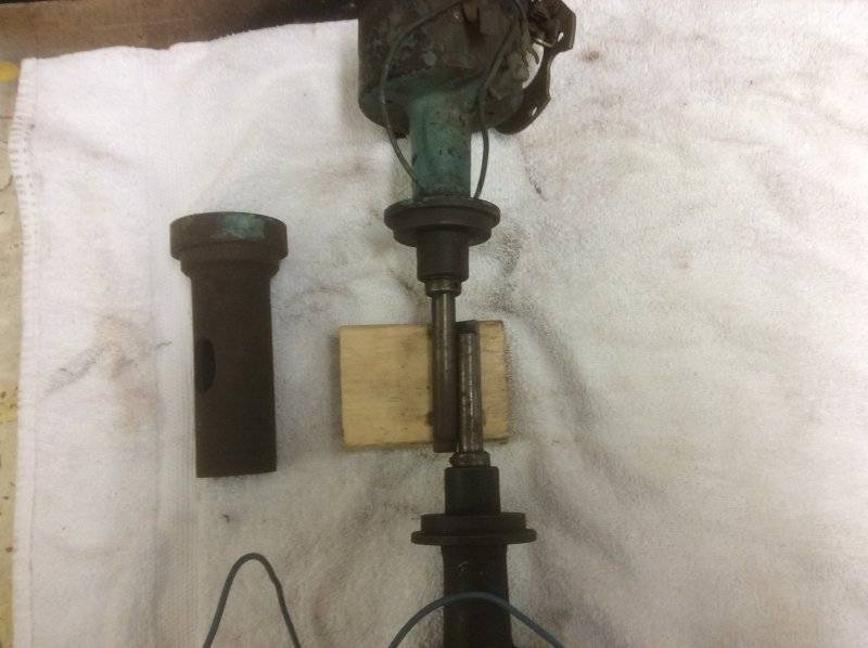

If cam was moving forward it would advance timing. It is probably forward and moving aft. I would look at button clearance. The distributor riding up a bit in the drive slot in a big block could be making your problems. I have always added a 1/2" shaft collar to the bottom like first picture to keep the shaft up in dist.
i pinned the collar to the shaft because i dont trust the set screw to keep that collar in place and fall down in my Expensive motor upon dist removal...ace hardware 1/2" steel collar.
TIG tack the set screw, cut the collar at set screw if you need to remove. Pinning it works also.
On a stock distributor you can replace the plastic collar (will break anyway when touched) and adjust out the excessive vertical play on the distributor with a drilled/pinned sleeve or collar.
