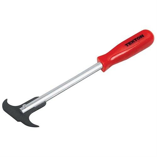

Would I be able to remove them using one of these?
My slide pullers are buried in my shed and I'd rather not go digging for them if I don't have to :eek:
Use the end of the axle just like a pry bar works great.
Yeah, that's how I usually pull the Ford seals, but thought it might not be as easy with the Chrysler rear since the seals are deep in the tubes rather than flush at the ends.
