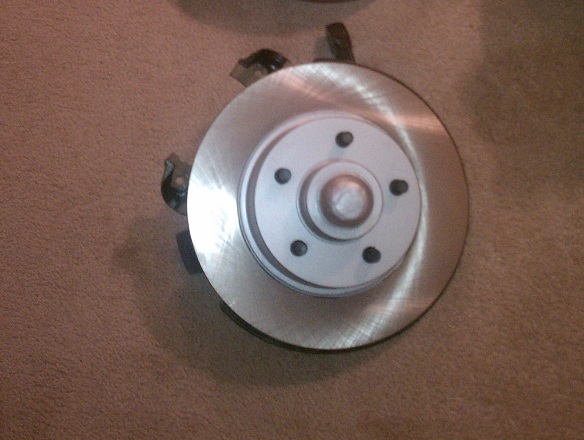

If you want to paint brake rotor center hubs and edges, rather than tape up everything,
  1. coat the rotor pad surface with vaseline,
  2. use crupmpled up news paper in the center or both sides to keep paint off race bearings
  3. When done, paint the rotors with brake paint rated for high temperatures.
  4. When paint is dry, use clean towel wipe off painted vaseline
  5. Spray brake cleaner on clean towel to get remainder off being careful not to get it on the paint,
  6. you should be good to go!
Here are my rotors with hubs and sides painted silver, this will help keep them looking nice and not all rusty over time.

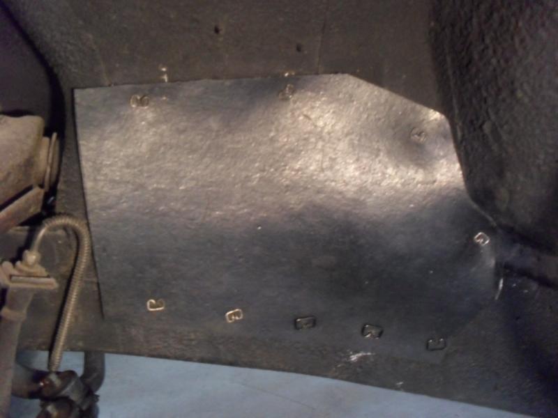

Needed to replace torque shaft splash shield inside left front fender on the 69 Road RunnerSAM_1951.jpg and found that an International front wheel mud flap is exact same material.Part #1675780C1
