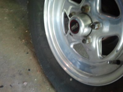

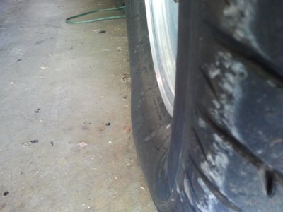

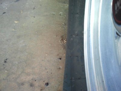

Rims that came on front of car are 15"x 3.5". Firestone was able to mount some 215 70R15's on there but they bulge out about 3 inches from the rim. How safe is this? Don't have a lot of extra cash for new rims but am concerned about this amount of bulge for driving on the road. They are Weld Prostar rims.

How much PSI are in the tires? Tire tread width should be pretty close to the wheel width for best results. How safe? It just won't handle very well but even if the right size tire is mounted, they still won't handle well. Narrow rims are designed for drag racing.....
That's just the weight pushing down which spreads the sidewall. Won't handle great, but its not a bulge. A bulge rotates...ie is one spot on the tire, that's bad, as it usually means a seperation...remember firestone...
No way. I've mounted a thousand tires when I was a mechanic for over 20 years and I can't believe they put them on. Those are dangerous. Could possibly blow out on the tire bead. Those rims as a previous poster said are for racing not for the street. You definitely need a wider rim.

those 8.4 inch wide tires are a bad idea on those wheels.a 165 80 15 is a good street size.185s would work ok as well.tires buldging that bad can come off the bead very easy and instantly deflate your tire.that is why they are a danger to run.
Ditto what the others have said. 215/70R-15 tires belong on 5.5" to 7" wide wheels. The thing you have to watch for on small tires is the weight rating. Most of the 165 and 185 tires are made for much lighter cars. Even if your looking at D.O.T. frontrunners make sure and check the weight rating. Nothing worse than popping a tire bead in a corner. I'd have a talk with the manager at Firestone and make him/her aware of the liability issues, not to mention having a pissed off customer with a wrecked car...
