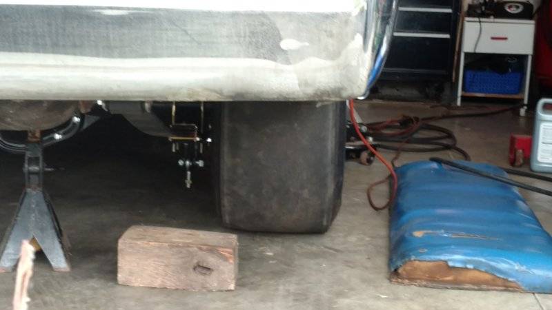

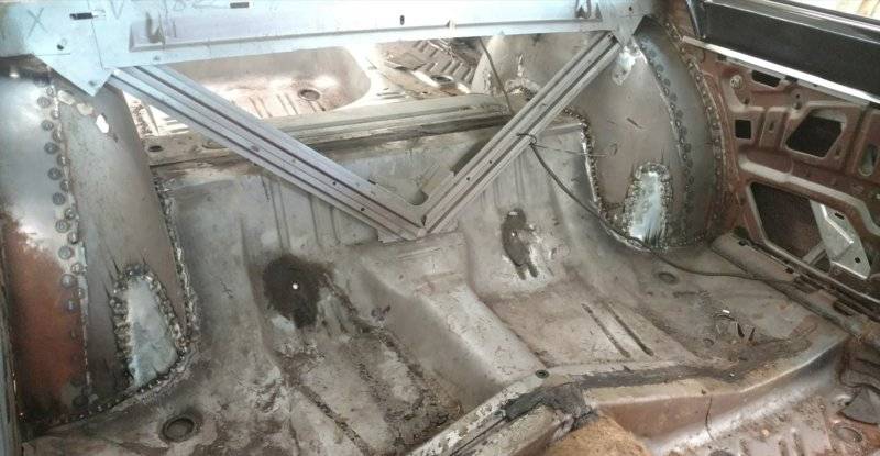

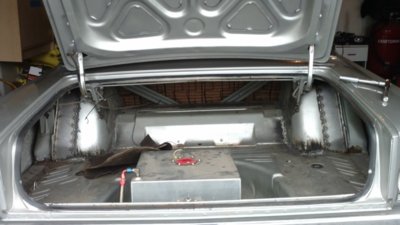

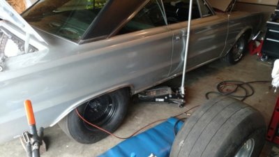

Here's mine 15x10 with 4.5 B's with 29.5-10.5w on a 67 Plymouth B-body
Doug, Interesting, and why I asked... I thought the bulge would decrease (stretch the tire more), and allow it to fit. Not looking to move springs or anything. LOVE the silver '67! May have to see if the 10.5W will fit. Are they ET Streets?
