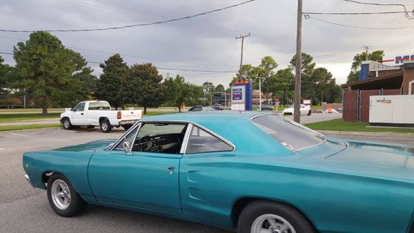

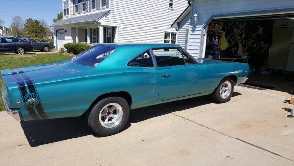

Absolutely ! Plenty of clearance ... I really think you could run 315 but wheel would need to be perfect ... these cars have huge rear wheel wells
