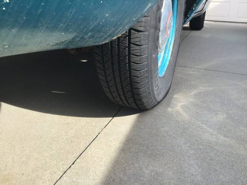

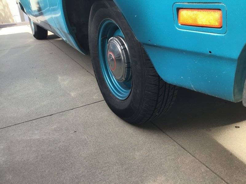

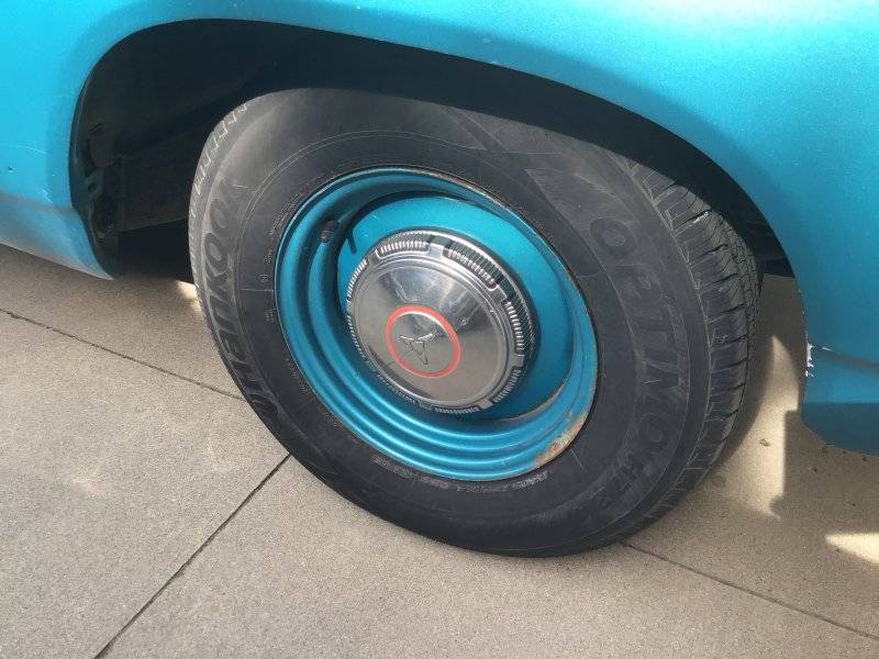

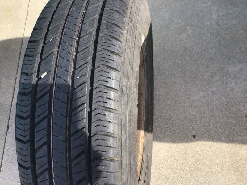

Here are 5" wheels with 205/70R14. Does this look right or does it look out of place? And last one is the spare, tread is just under 6", the sidewall is 8" total. Anything wrong with a 205 tire on a 5" wheel?
That looks fine, but in the pic it does not look like a 5" wide wheel, and for clarity, where exactly are measuring the tread width?
Cameras up close often distort what we see.
While we are at it, does this tire pictured also measure 8" wide?
The wheels are absolutely 5" wide. I mounted all 5 tires. Look at the photo, they are claiming 5.0 also.
Yes the camera does change the look of things a bit. These tires look small and not oversized at all for the 5" wheels.
I'm measuring the tread where I can see the wear from the road. I used the tire for 6 months. All measurements are from the spare, I didn't lay on the ground to measure a tire on the car.
Tires are all sized metric not inches.
The first number of a tire size is the section width, or the widest part of the sidewall bulge. Nothing to do with tread width. a 205 sized tire is 205mm thru the section.
The next number, 60/70/ what ever is the aspect ratio or the height to width ratio. It means 60%, 70% as tall as it is wide.
A 205mm tire is 8" thru the section. The tread width may only be 5-6".

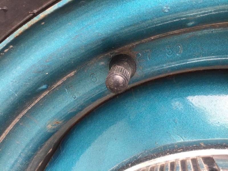

Why the tube?
I have 235s on 6” rims, and 255s on 7”. They drive perfectly fine.
Years ago I ran 255s on 5.5” rims. The center wore faster, but still nothing noticeable in handling and driving. And way better than what the car was originally equipped with.
I’m thinking about putting 255s on the 6” rims I have now. If not, I’ll buy 7”.
Without reading all the posts...a wheel width should be at least the width of the tire tread for good performance of the tire.
I put down measurements in inches so us USA guys can relate to the measurements.
Why the tube?
No tube, it's a valve stem
