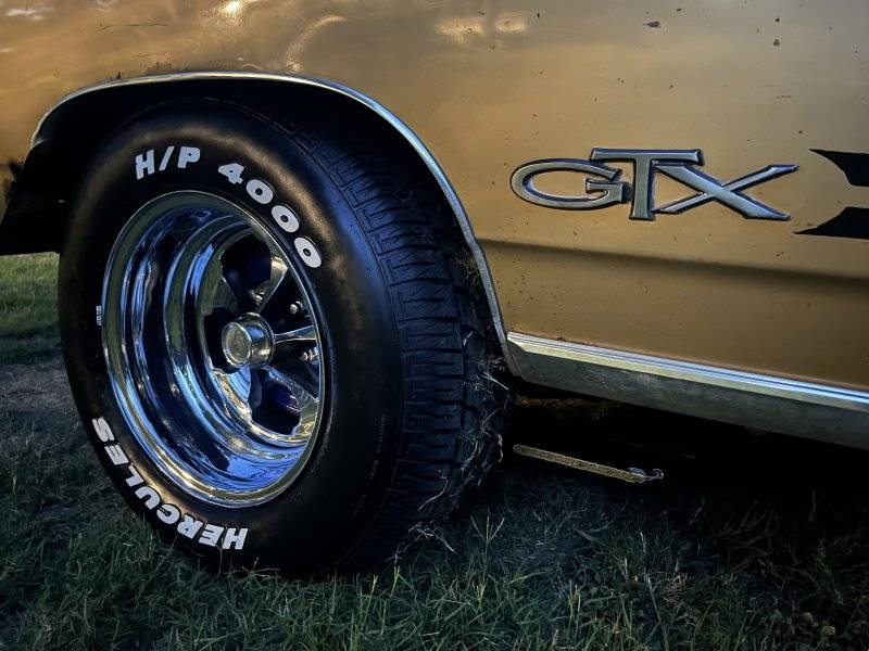

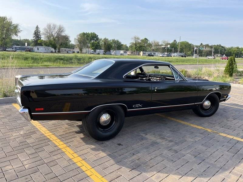

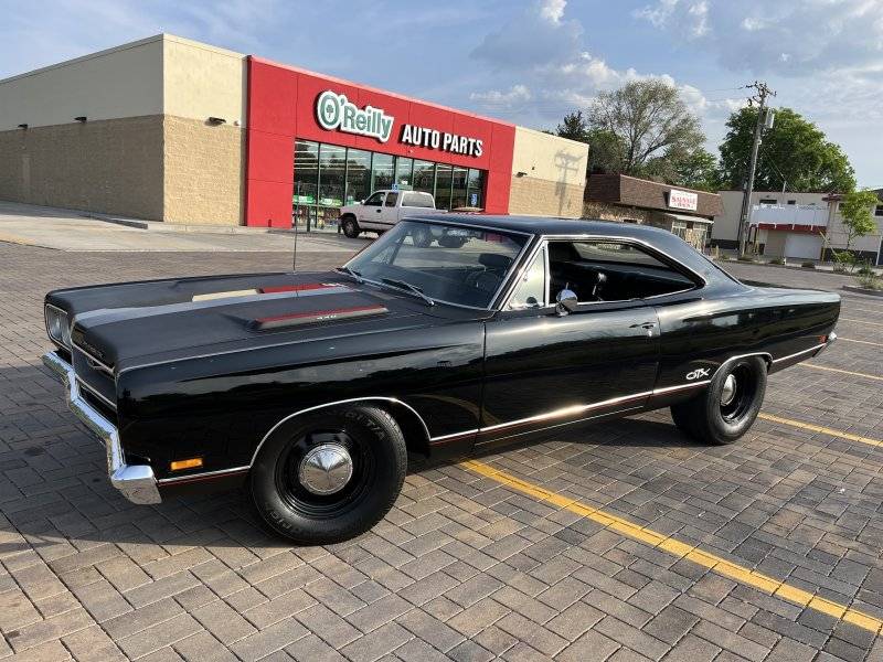

I have 2 cars with 15x10 rims. 295/50 on one and 275/60 on the other.

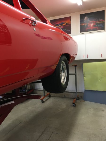

This is a 15 x 10 wheel, 5-1/2" bs. The tire is a M/T 28 x 12.5 x 15. The diff has been narrowed 1/2" per side and I have about 3/4" gap to the wheel lip. This is obviously not "ride height" as there is no weight on the read suspension. But one thing worth noting is that I have 10" drums and with the suspension hanging as it is I can JUST get those tires in the opening to to mount. Any bigger and they wouldn't go. With a stock width rear end they likely wouldn't fit.
