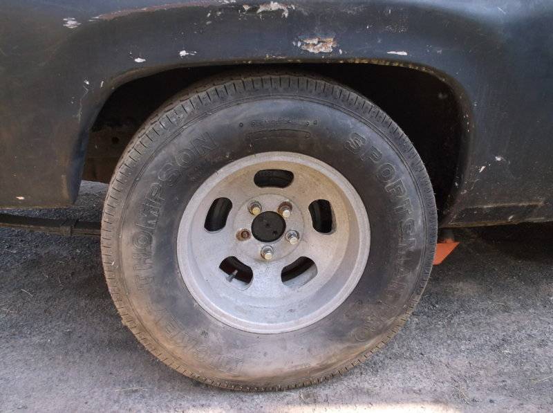

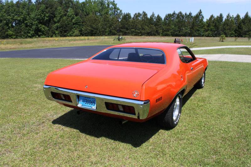

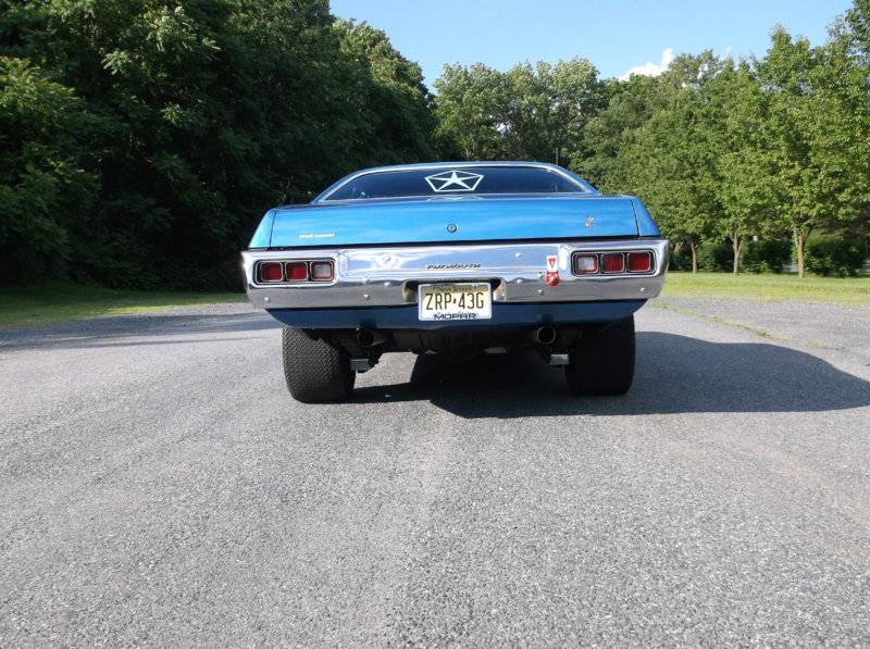

I'm not sure of course but, I'm running N-50 x15 on 8.5" rims with a 3 1/2 " backspace on my 73 which I believe is the same size (rear) wheel well as the 71, 72 and 74 cars. The N-50 is approx. 11 3/4" wide. I measured the inside to outside of the factory wheel tub to be approx. 14". I have a narrower rear so my clearance is different but I will post a picture of a 29" x 12.50 tire on an 8.5 " rim on a friends 73 Satty. You can see they make it but it's tight. I'll throw in a rear picture of mine as well just for the heck of it. I have about an inch of clearance on the outside and more inside. I am actually closer to the spring than the inner well. Keep in mind that 295/50's are lower profile than my 26" N-50's as well. The offset and wheel width will decide how centered the tire will be. You could try a tool like Percy's wheel fitment tool to help you out with what fits.

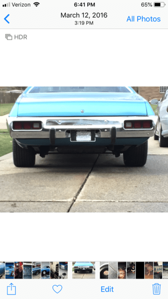

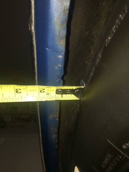

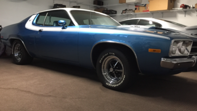

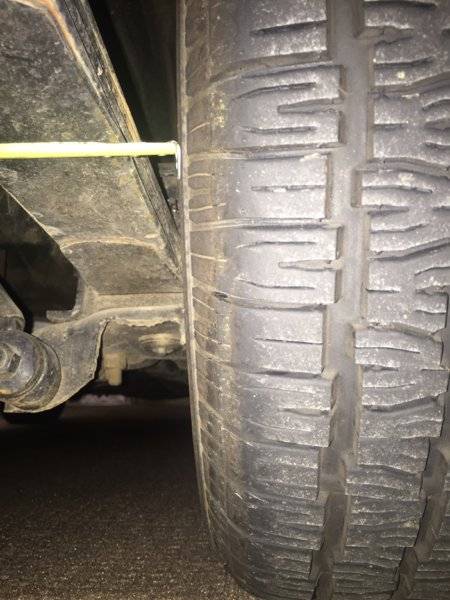

I have 295 50s on my 74 with 8” wheels with no problems. I can send pictures if you need
Yes could you send some pics. How much room do you have between the tire and leak spring ??
Sorry. I just saw your reply. I’ll try to get pictures and the space for you tonight or tomorrow. My car came with air shocks but it is fine without any air. I don’t fill them. Mike

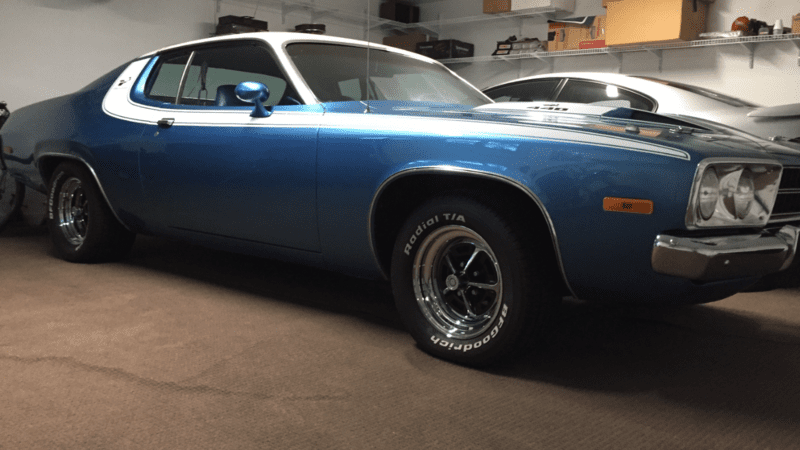

Sorry. I can’t tell if it worked. There is an inch between the wheel well and also an inch between the leaf spring. I gave one of the way the car sits so you can see there is no air in the shocks also
