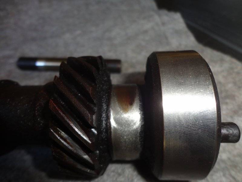

So now it's back to getting the cam out. In the process again I find this.
The pushrod for the fuel pump has the end worn off severely, and the lobe on the cam has worn down as well. You see how much the pushrod has worn compared to a new one. Now I'm thinking I have the whole top end open is there any chance there is any further damage from this. I decide to go a head and bite the bullet and pull the heads to see for sure. Well here's what I find.

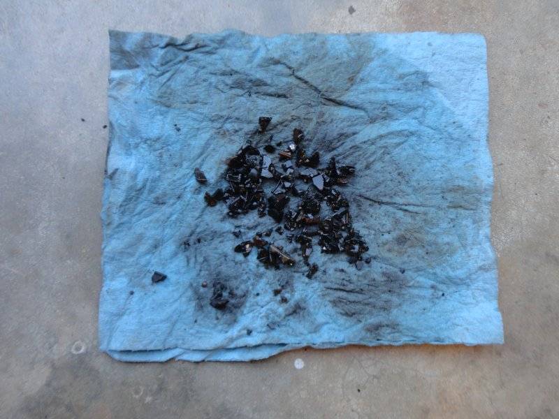

Well the engine has been disassembled and found to be worn out everywhere. The mains were scored pretty bad and a couple of rod bearings were close to failure with nothing but copper left, but none had spun. So it's at the machine shop as we speak. They called me today to say the crank will end up at 0.010/0.010, and the cylinders will be good at 0.030 over. All I need now are parts. While cleaning all the misc parts for reassembly I was washing the oil pickup and it was making a clinking noise. I laid a towel on the floor and tapped the pickup on it and this is what I got.
There are the remnants of the original timing gear that I has suspected had gone bad. With the bearings being as bad as they were I didn't even take the oil pump apart. I just threw it in the junk pile. Luckily she will live to see another day as this is the numbers matching engine for this car.
