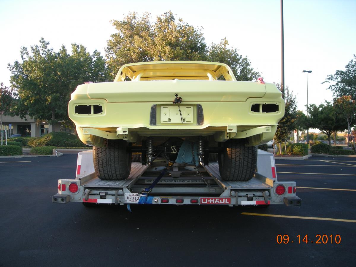

Unless you really plan to hit that car hard I would just swap for a new set of gears. I thought of a swap and then said the heck with it because I had the wrong length and missing pieces and the springs did not line up and had a completely new Strange Eng dana 60 built for it... Tons of cash, but Done right the first time....
I replaced the tapered axle rear out of my '64 with one from a '68 GTX. It was an easy swap. My drums were all beat to heck from years of people removing them without the proper puller. The post-'64 rears are easier to work on, but with the proper puller, the tapered axles aren't a big deal - just a little more work. I do have the puller if you need one. One more thing about the swap - the '64 B body rearend is the widest of the B bodies, so you would pick up a little more tire clearance if you swapped.
