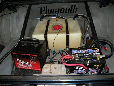

thats my question to you racers.
in your fuel cell do you use foam or no foam.
I have a 8 gallon jaz cell and just decided to take it out since its over 12 years old and its getting brittle.
I was going to replace it but I think it might have been restricting my fuel pump flow.
Any non foam users out there?

from the looks of your fuel cell you could use a new one. the top of it looks like it's dropping down.

i like my clear cell. it is sunken in a little but not bad.im still on the fence with no foam since i have a fuel pump return and a regulator return all going back into the cell.
i hope it wont get too aerated before a run.

I like the clear cells you can see fuel levels at a glance but they are the most prone to oxidation also, maybe you can pull the old foam out & replace it with new cell foam...
i had to put new foam in. with a regulator return system and a fuel pump return back into the cell all at the same time. it looked like a tsunami in the cell while the pump was running..
