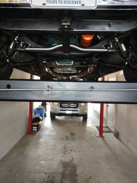

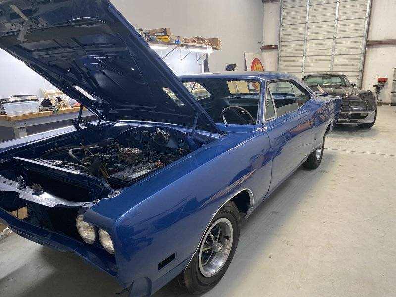

Sway bar question regarding my 1969 Super Bee I'm restoring; K member has the brackets, but no sway bar on car, did it likely come with a sway bar installed from factory? and if so what size, etc? If I need the sway bar, and I assume I do, I would like to keep something close to factory and basically bolt up without any modifications. Any direction on this would be appreciated including the best source to purchase, etc. TIA (pic for illustration, got a long way to go but making progress)

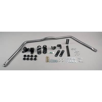

That car had a sway bar and you won’t like driving it without one. Should be plenty around used or pick one from any of a number of venders. It has to be the one that is curved up in the middle. The 70-up bar goes through the k member and is a completely different bar. It’s flat.

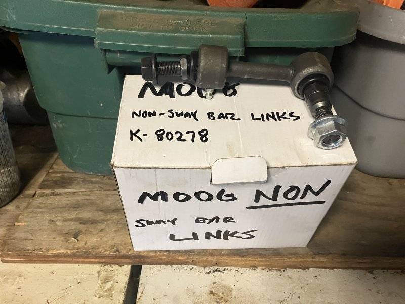

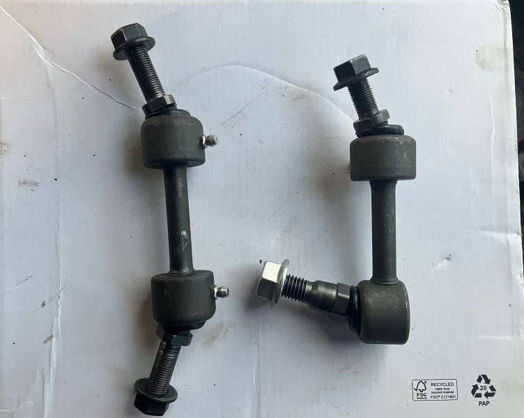

I use and recommend the ford ball joint end links. I got moog off rockauto, part numbers are floating around on here and elsewhere. I think it’s from a 2016 f150. Direct bolt in. Pretty cheap and no downsides unless you are doing a Concour correct car. I don’t know if they work miracles, but they sure seem to work good.
My 67 coronet was an ex bracket race car. The factory front sway bar was removed. I got it running and drove it for awhile. Not very good road manners. Decided to rebuild the front suspension, and put the sway bar back in. World of difference. There are several aftermarket companies that have kits that bolt right in if you don't have the original. Highly recommend it.

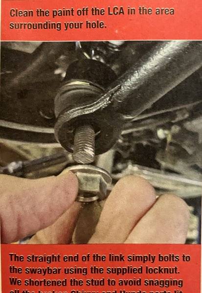

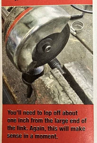

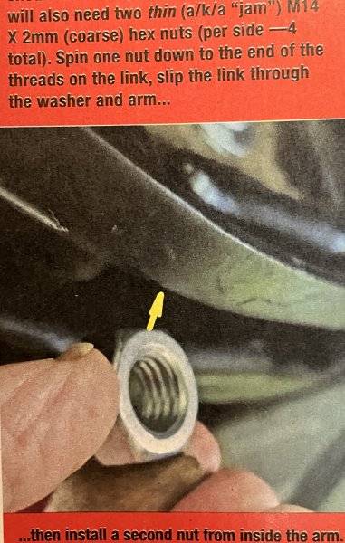

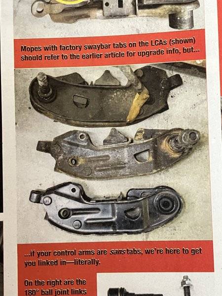

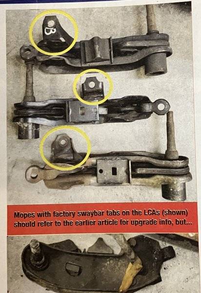

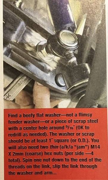

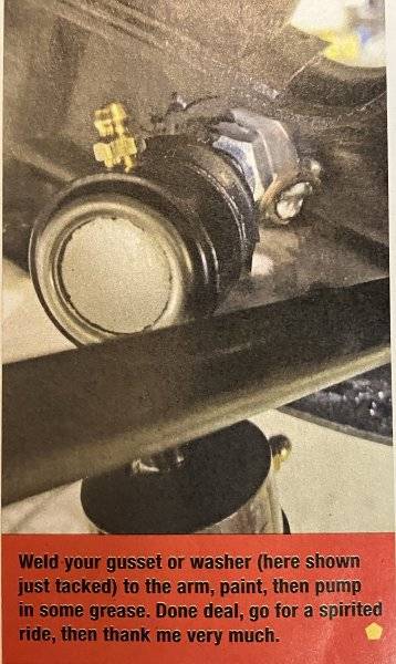

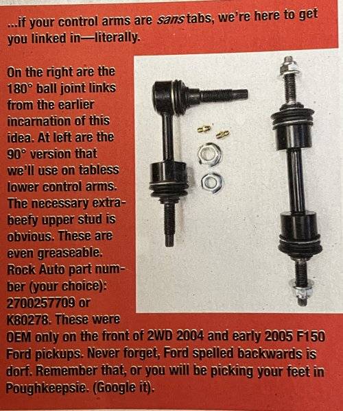

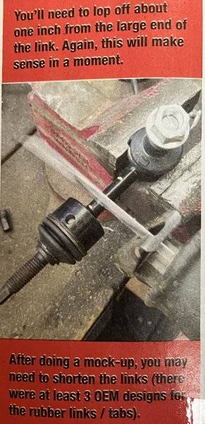

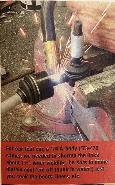

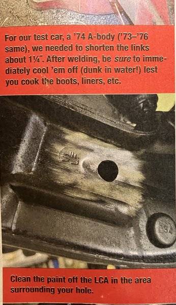

To utilize the sway bar, you need a manner to connect it to the lower control arms. If your car does not have the OEM style LCAs with the mounts, you can use links like these:

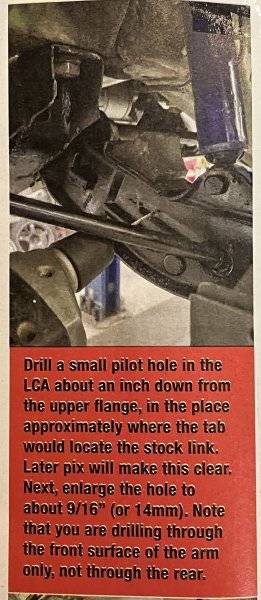

The ones on the right....the straight threaded part connects to the sway bar, the 90 degree angle section fits through a hole you drill in the lower control arm.
You can order them through RockAuto.com
