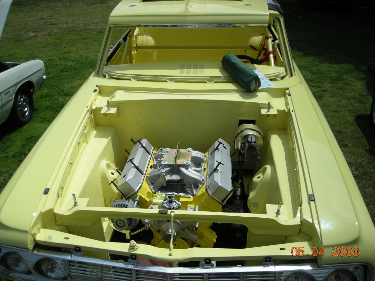

Here is what I did to my 64 Sport Fury. I will not be using a heater and using an auto tranny. Electronics will be inside with me and I am not sure where I will punch out the holes for wiring. With this economy, I am forced to hold back on more work till the end of the year and the car is scheduled to go back in the paint shop for a little more work within a month or so. Some people like the smooth look and some hate it. Lift off glass hood too !
Cleaned up the cowl and no wiper arms either !!
Very very nice. Clean and straight, that's what I'm lookin' for. I am going to assume, this is a race car. No color selection for me as yet, but I need to make that decision pretty quick [I worked as a automotive painter for several years in my other life..!] and I'll be doing the paint work. Probably a two tone, but that too, is still up in the air.
Thanks for the post...that gives me some encouragement.
