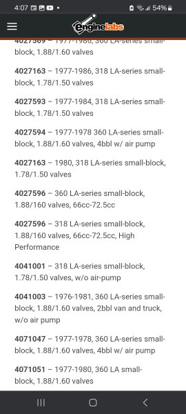

4027163 perhaps?
But I don't know what the hell that is so a description would be nice. So that way I don't waste time looking up some V6 baloney.

Neighbour thinks it is 4027183, so did I, but it could be a 4027163. That is what I found. 77 to 86, LA 318. It looks like both ends are drilled for bolts. One head is mostly clean. Will have a close look when the other head is clean.
