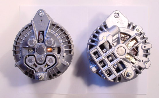

Sorry my total beginner question - but when shopping for a new alternator - what's the difference between a round back and a square back - is it what it sounds like? Bought the car with some kind of aftermarket 60 amp alternator, but when switching to some electrical fans, EFI and some other parts I noticed that I need more. Should I remove the one I have and check or can you tell from pictures?
Round back and square back is just about rear case design/shape, not output.
Roundbacks gets diodes pressed in to the case, squarebacks began to be more "serviceable" with diodes attached to metallic plates, easy to remove and service.
Squarebacks began in 72 with slight changes at the end of 70s
