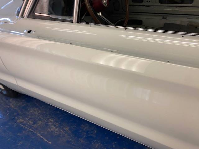

Hello I am looking of a source and a picture for top of door trim clips. I am looking for the clips that go on trim on upper door. Thanks

I did not think the piece of trim I am referring to used the bolt style clips . The very top of door trim by the side window I just remember there being some spring style clips .

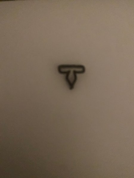

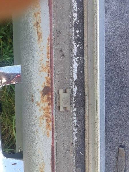

On the door, all the clips are these plastic style and on the ends there are a bolt style.
Can't find the picture of what the bolt ones look like but here is a picture on one of my parts cars of an original clip.
Punch those pins out and carefully squeeze the tabs from the bottom and push it up and out. Mind you your temperatures might have made those clips to brittle to reuse.

Yeah, they are very ify. I have new ones if I need and a couple different original styles of the end bolt ones. My car has all the trim, just adding parts to my collection for the "Just In Case" scenario.

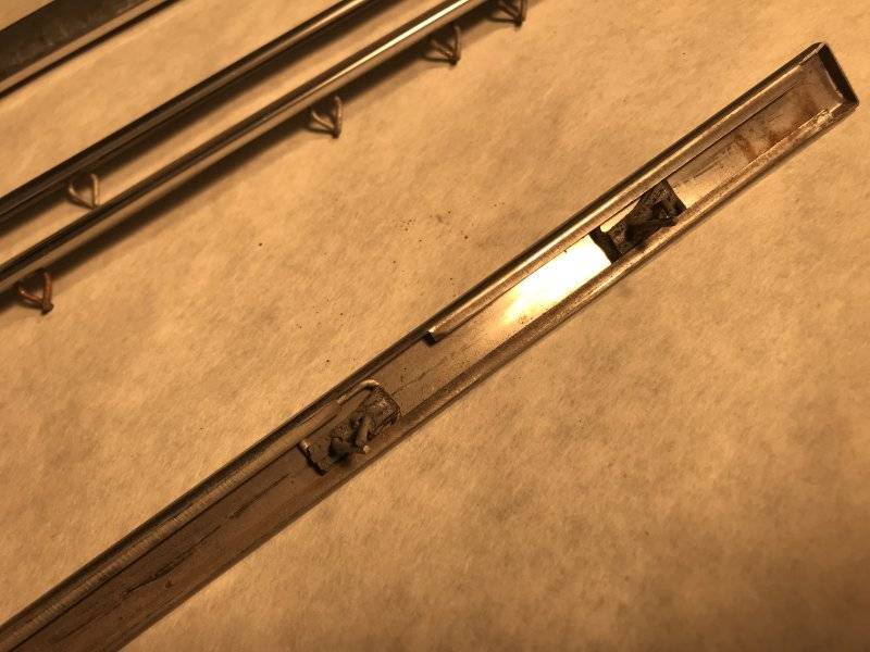

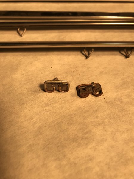

Is this what you're asking about? These are top door moldings from a '66 Coronet 500. I would think Charger clips would be the same for a molding in that location. I don't know where to source replacements.

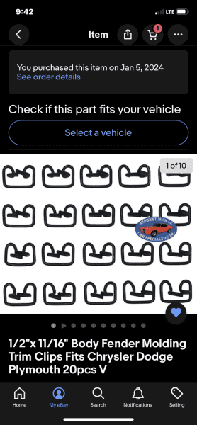

I got mine off eBay and they fit perfectly I just had to add the clay type stuff

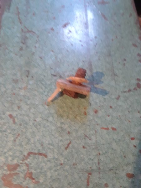

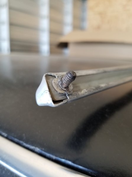

Here is a picture of the bolt style attachment for the door trim moulding.

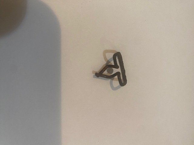

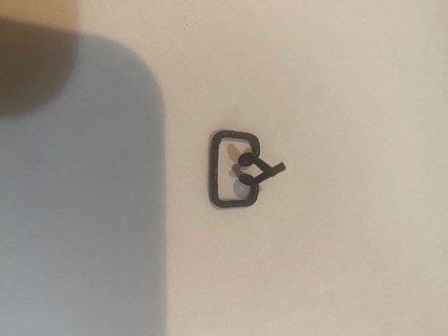

Hello,
I found a clip on a door in the pick and pull photos attached
