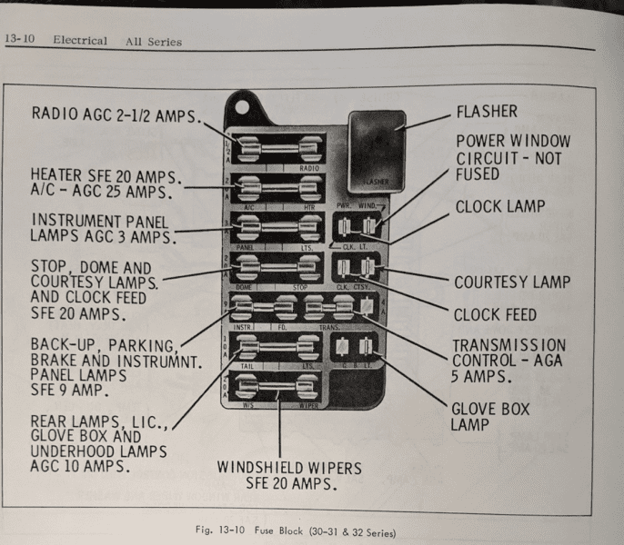

Sweet. I was looking for that. Is the supposed to be a sticker in the car and if so what is the correct placement? Is that illustration correct for my 74RR?Forgot the Radio is AGC GThis is GM though. Owners manual or FSM should have the list.
74RRI have never seen a sticker. Usually in that literature or printed on the fuse box. What car by the way?

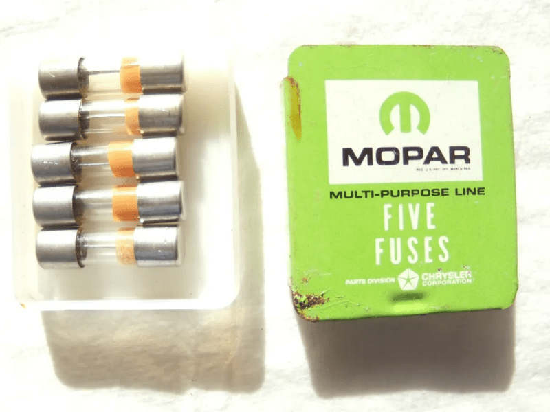

Not sure. Have to watch the cheap fuses say they are rated 20A but actually blow at say 30 amp lots of threads on these. Want me to see if I can cobble a set of them together for you? Older ones mostly Buss. Seriously have alot of them have a fuse display I have been filling up over the years so have to buy lots when you see them out there. Just need to know how many of each you want. Say $2 a fuse shipped.Will this work? It looks like it has shorty and long fuses in there

HALLIFAXHOPS......YES....fuses are based on AMPERAGE, DIMENSIONS and MAXIMUM VOLTAGE of the system they protecting. Example: SFE 20 amps at 32 volts. BUSS fuses say SFE translates to a glass barrel fuse......VW ones? No they should be SFE sized, different amps of course.
