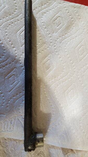

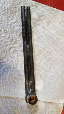

I made own torque converter bolt wrench. Six point socket ground down flat(remove chamfer) & height to fit and welded to home made handle. My handle is about 10" long for working under car.

The custom wrench above looks like it might do the trick!

My homemade wrench also minimizes the chance of rounding the bolt during install. Press the socket tight against the flex plate to keep iy properly engaged.
Heat the shank of the 6 point wrench and bend it to the optimum angle. Then a little heat on the bolt or converter. Heat always helps with locktite. Get the wrench to fit. Wedge a pry bar or screw driver between the block and wrench to hold it tight against the bolt. Then smack the wrench with a hammer. The shock will break it loose.
