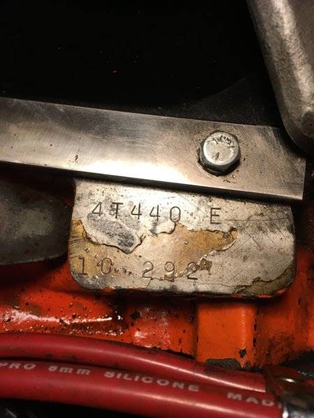

Here is a pic of engine block stamping.Should this be an internal or external balance?
4 = 1974
T = Built at Trenton engine plant
440 = 440 cubic inches
E = CAST CRANK
External balance engine built on the 29th of October by 2nd shift
Thanks Lefty,answered a lot of questions there. My h/b is the skinny one and t/c has no weights.

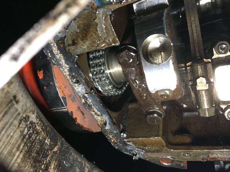

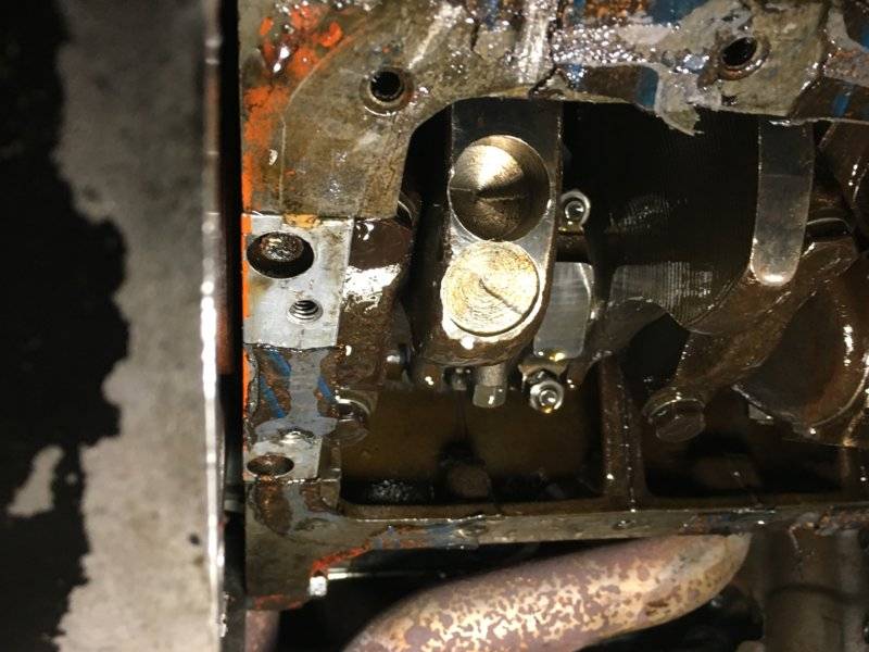

Pulled oil pan today this is what I found. Thought cast cranks were externally balanced. Glad I opened it up! Now I know what I have
2ECCCB27-CE17-4CD0-9B7C-B66A8C99843F.jpeg B0701B98-2BAE-417D-9048-E70686269BC2.jpeg
looks like that one is balanced
what concerns me is the mallory in the left pic if that is what it is below the hole
that comes out it destroys your motor
ask me how I know
so what do you think you have?
I see an original cast crank engine, that has been rebuilt with non-original parts.... That sure looks like a thin damper, and a forged crank to me, so I'd say that setup is zero balance, and so should your flex plate/torque converter. I don't see as good as I used to, but I don't see any Mallory metal.
