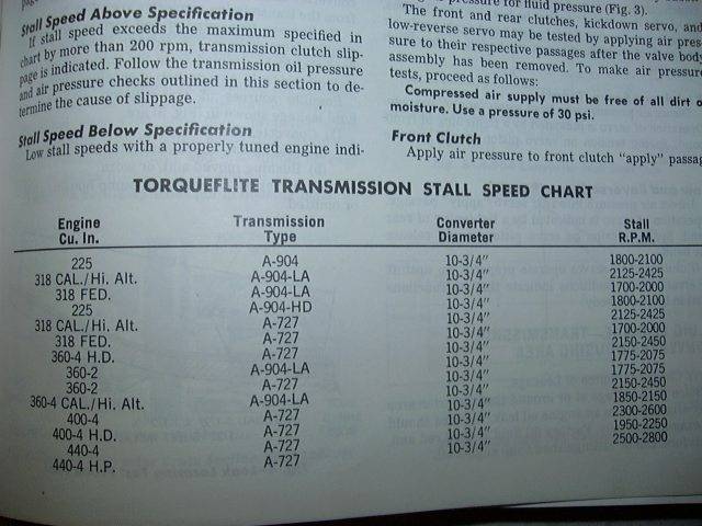

Factory converter ratings as per the service manual:
So the manufacturer also specified a 20,000GVW trans cooler for use with their TC. Everybody else install something like that with their TC?
