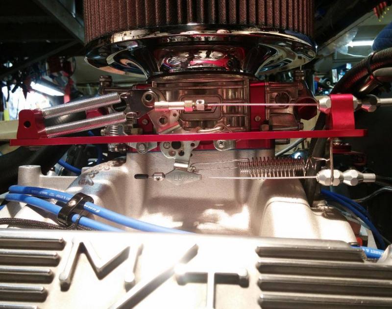

Here's mine:
According to the instructions, it's set up correctly on the carb. I'm not sure what is on the transmission side of the cable yet. My set up doesn't have the springs. I guess he just didn't put them on. I'll have to get up under the car and see what he's got under there. I bought the car like this, and the guy did all the work to it himself...I'm going to be going back through everything and fixing odds and ends.
You can disconnect the carb end and see if it moves in (toward the tranny) that would tell you the valve is open too soon.
When you disconnect the carb end, it's lined up with where it clips on perfectly. There's no slack, and it doesn't move towards the trans at all
When you pull on it does it move back on forth freely? How about tranny fluid, is your fluid level good?
Basically you need to raise the throttle pressure some which means you need to shorten the cable a bit. From where you are at I would not even worry about any instructions as I would just shorten the trans throttle pressure (kickdown) cable a little and see how it reacts as it should raise the shift points some. It needs to pull the arm (throttle press/kickdown arm) a bit more down on the trans as you step on the gas. And you have to shorten the cable to do that. Now you also have to check for full throttle when done as many times on aftermarket kickdowns with aftermarket intakes the linkage geometry is not right and the throttle pressure could bottom out before full throttle. It should not but you want to check it anytime you change the kickdown linkage adjustment. Ron
