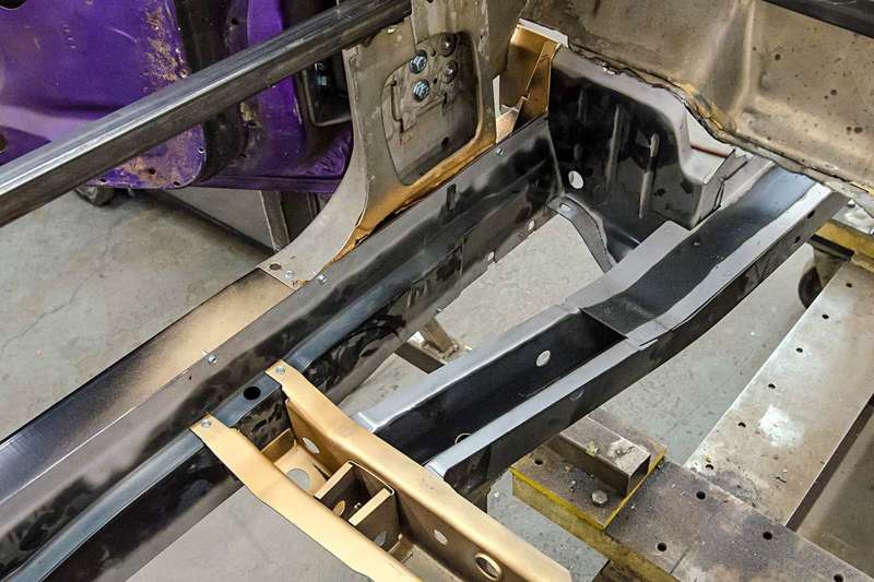

Here is an image that shows how everything ties together.

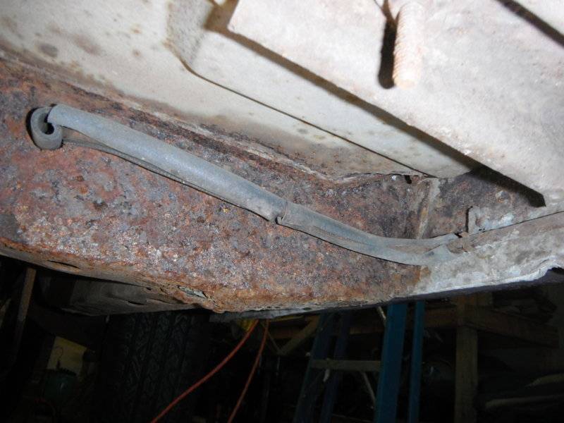

Thanks for your input. I checked the whole under body before I bought the car frame rails were surprisingly good but not that cross member. The only other bad part was the left inner front fender which I already removed from the car. New one is here already.

Based on that picture, it looks like there might be 2 more under the floor that hold the top of the crossmember to the front rail.

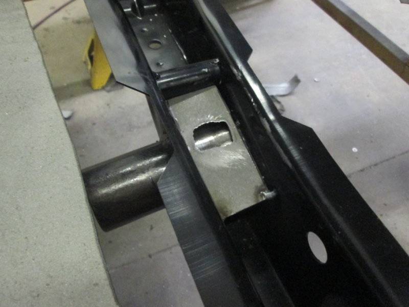

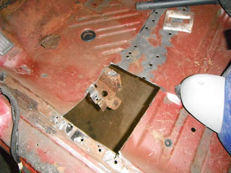

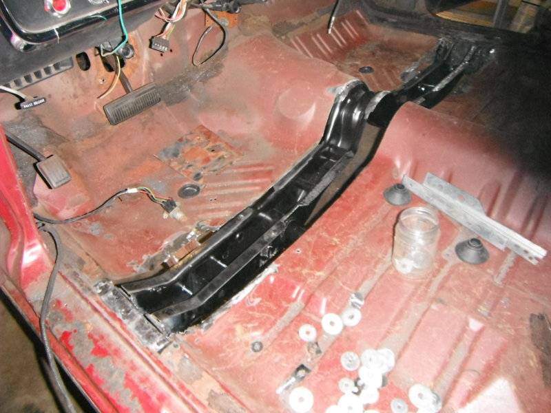

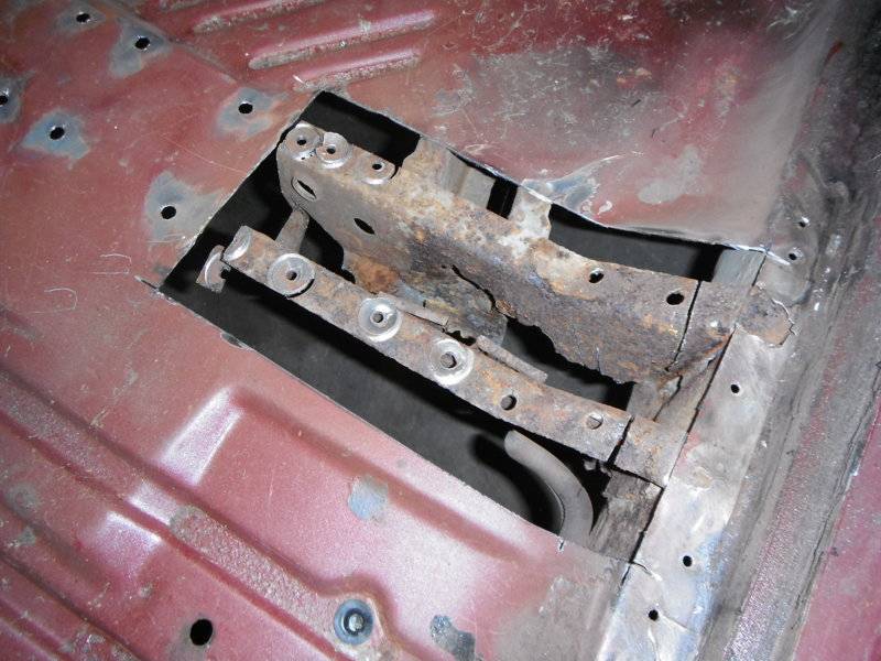

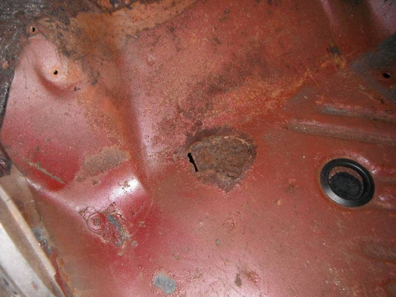

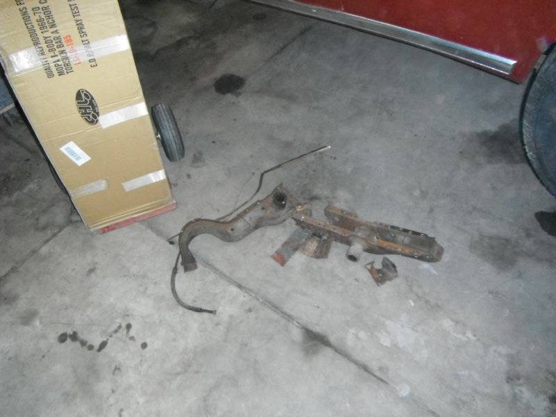

Got most of that torsion bar cross member out today it took eight hours. Found two small palm-sized rust holes near the toe board on both sides. Could make it nice with new floorboards, but the car is not worth that so a first-class patch job is called for.

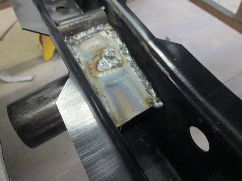

New one is in and boy take my advice and don't buy a cheap one. The fit was terrible but since I have more time than money I saved a couple a hundred. It's just tacked in place tomorrow I'll finish the welds then remove the K member.

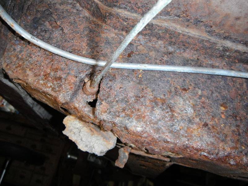

I took a break from the body for a couple of weeks, doing small components for a while. Had to order a new welder gun off eBay they were much cheaper than ones here in town and to top it off the left frame rail was rotten on the bottom just aft of the control arm mount. I never noticed it as it was a pinhole that grew to an eleven-inch piece. I used a body hammers pick end to find further damage. So far the right one is solid. The engine block is at the machine shop for cam bearings. Take my advice, let a pro do them. I bought an eBay installation tool and trashed two of bearings and broke the tool in doing so.
