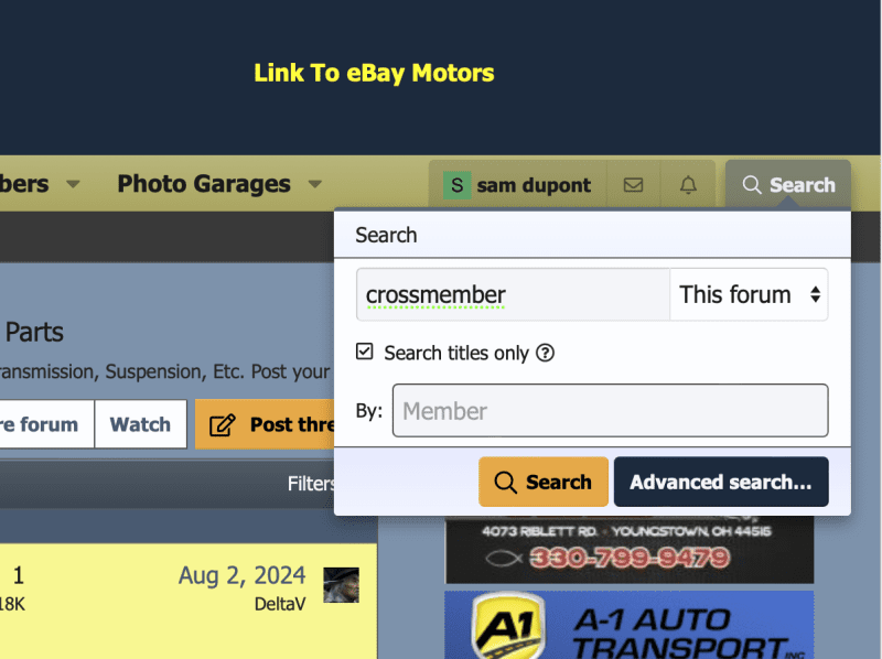

upper right corner of this page it says: search
That will give you a drop-down that looks like below.
I chose for sale Mechanical Parts, but people post in various places

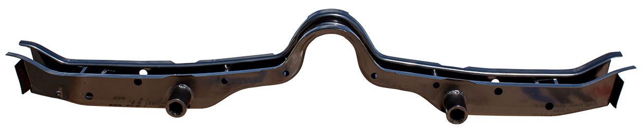

I suggest replacing the whole piece with a used one. Try moparmarks (?) on this site

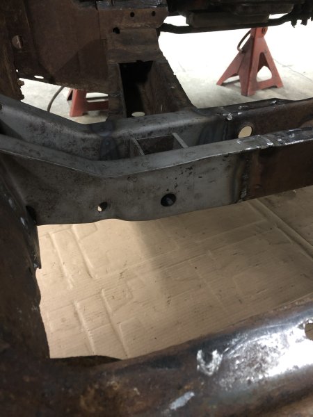

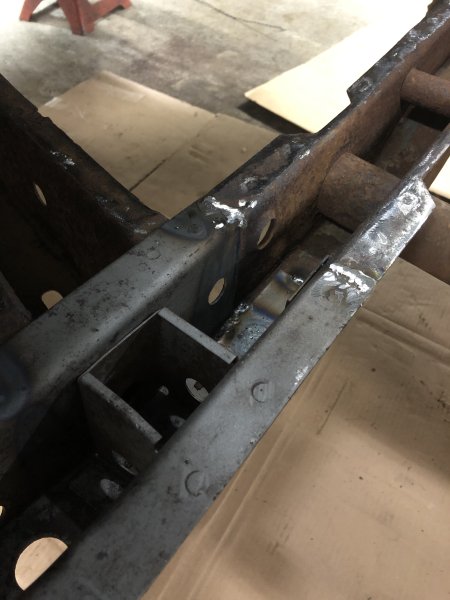

Posts 25, 26 and 27 are pics of what my crossmember started out as. Posts 42 and 43 have a few pics of the finished product. Used the AMD crossmember and used the ends only. I added "fish plates" and sub frame connectors (just 2"x3" rectangular tubing). I hope you plan to remove the floors as access to the entire area is necessary IMO. I needed to replace front floor sections as well. The nice thing about only replacing the outer sections of the crossmember is locating the new pieces is easy. I did have to massage the AMD pieces a bit. I was not at all interested in maintaining the factory appearance. I also made new inner rocker panel and front frame rail sections. I modified the center hoop as well to allow for an A500 transmission. Eldubb440 is the master at these things. Take any advice he gives.
