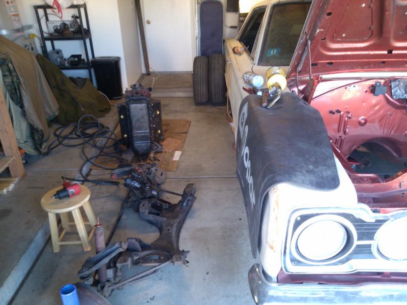

Victory! Thanks guys, invaluable resource this forum.
