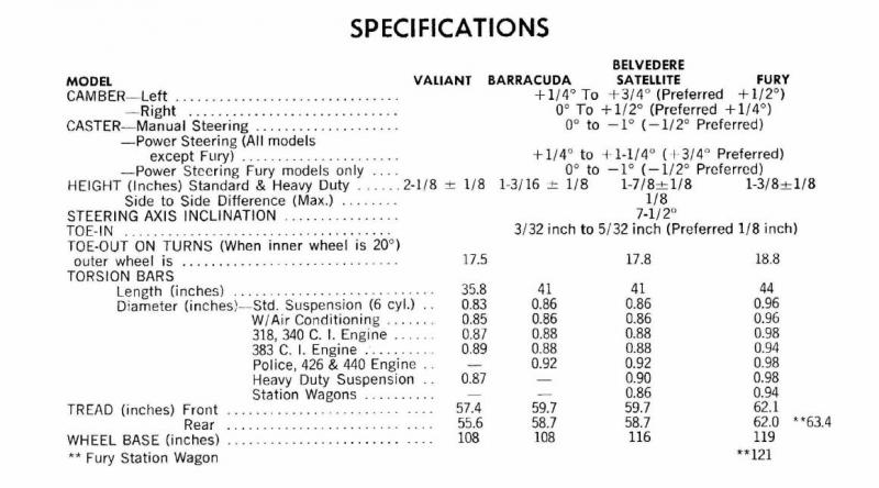

Did big block cars come with different bars than small blocks, or did both use the same bars?
Here's what was listed for 1970, from the Plymouth manual.
I would certainly go to a bigger bar. IDK about there spring rates for there diameter bars, bu MoPar IIRC does list the spring rates.
Considering it is a B body, I would at a min. use the same diameter bar as stock. I myself would use one at a step thicker for driving on the road use, 1 thinner for a hot street/stop light bandit car.

My personal experience is my '68 Satellite B body had .088" bars with a 318 when I got it. A 360 motor went in and then I changed the bars to .092", which is the biggest stock size offered for big blocks back in the day and is now agreed for handling to be a little soft (but great for 1/4 mile racing weight transfer!). Not much difference that I noticed at all. If i were to keep this small block for the street i would go with at least .096" bars and maybe 1.00". However, I'm building a big block 451 so the car will get either 1.00" bars or the next size up 1.03". Every .03-.04" increases stiffness by something like 14%. So a 1.00" bar is not the same as a 1.03" bar. Bear in mind that ride quality on the street is subjective - some like it plush or soft while others like it a little firm and still others like it almost race track jar your teeth firm. I think I've read some here are running the largest bars that Hotchkiss offers, which I think is one or two sizes up from the 1.03" and for the street they are pretty rough. Remember, most of these aftermarket suspension goodies were designed for track racing and we're trying to adapt it for the street. Sometimes it works, but there are times when too big is too much.
