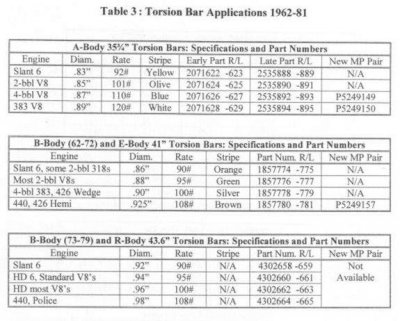

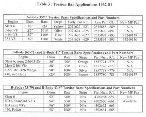

Found the chart

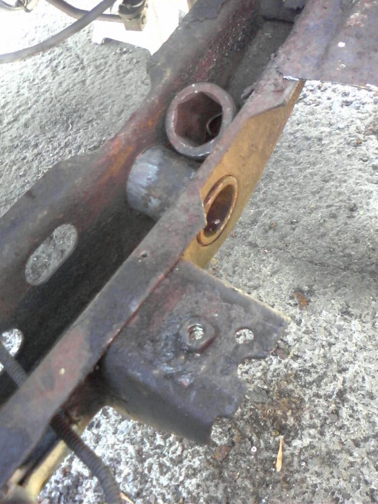

However... the holes in the trans cross member the 73+ torsion bars go through to the ISO anchor ARE the right size to weld in the anchors to (YES I have measured and taken pix) however I had NOT measured for bar length.
Point is you may be able to weld in anchors and use the shorter 72- bbody torsion bars in the trans cross member. Other member may have considered this and tried it so hopefully they can chim in with thier measurments or experiece

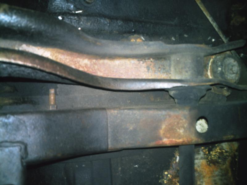

Here's what I mean about the torsion bar going through the trans cross member and into the ISO torsion bar cross member... Now I placed a tortion bar anchor into the hole in the trans cross member just to see if it's possible and it fit nicely. Unfortunately at the time I did not measure ti see if using the shorter 72 down was possible...I'm sure I can take a measurement in the next couple days after the rain stops, if anyone is interested
1962-72 B bodies used the same length torsion bar. If you have a 73, your options are limited.
