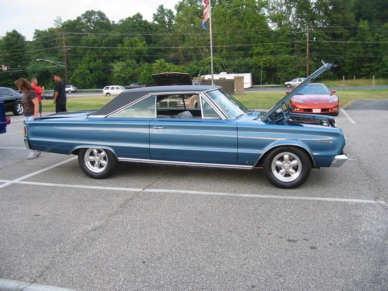

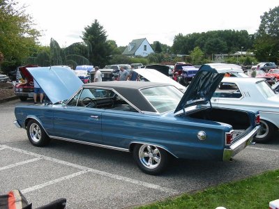

Your front ride height is adjusted w/ the adjuster in the middle of the LCA. Until you get the weight of the engine, trans and other components like radiator installed, you really won't know were the front end will be unless it is already sitting on the LCA rubber stops. That is not were you will be running it. I also used the ESPO springs and things HD rear leafs and the car sits nice. I plan on a set for my Satellite when I get to it so I can get rid of the air shocks. Heres a pic of how the Belvedere sits.
