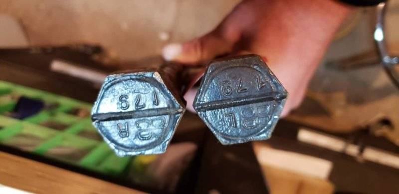

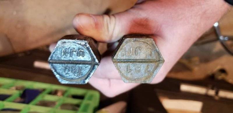

I've been looking for a picture... but I'm pretty sure I have that correct with odd number is left(driver) and even is right side. Also a L and R on them.
Here you go. Part number end and date code end...sorry for the upside down....

780/781 above are the part numbers. Even numbers on the right side, odd on the left. Date codes (179) above are the 17th week of 1969.
Hope this helps?
