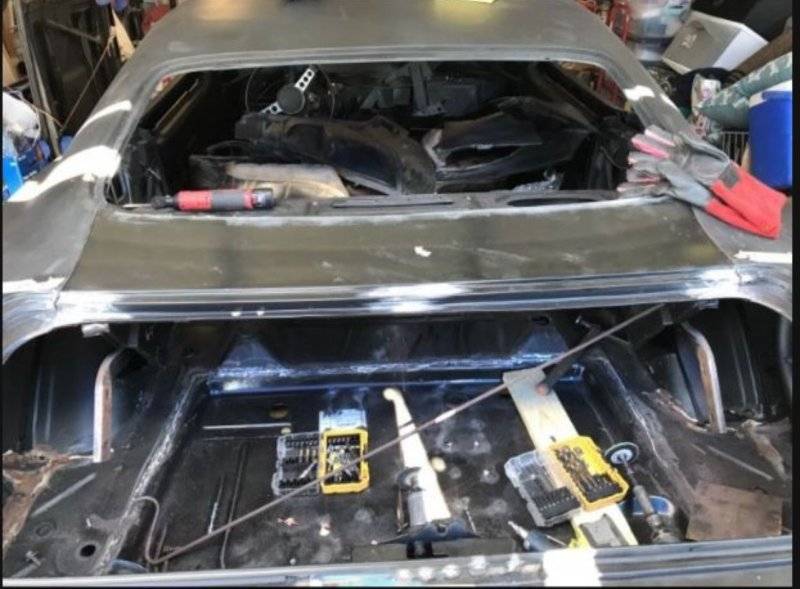

Regardless good luck on the project op I just hope you actually finish the car because here’s two guys that also wanted a lot of horsepower
