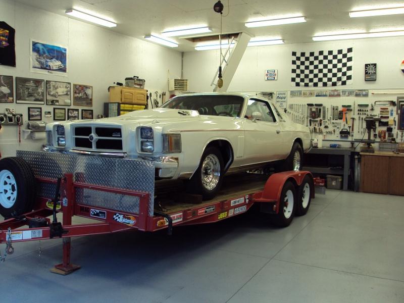

Probably not going to be enough truck. Make sure the truck is rated for the GVWR. Probably in the 10,000 lb range for that application. Hitch will have to be a class 4. I tow in hilly country. BIG B body and open 18" trailer Combined weight is around 5700 lbs. My tow vehicle is rated for 7,000 and has a class 4 load distribution hitch - 2 5/16" ball. I tow with a 2010 Jeep grand Cherokee with a 5.7 Hemi in it. Tows good, but does grunt up long steep hills. 300trailer.jpg
