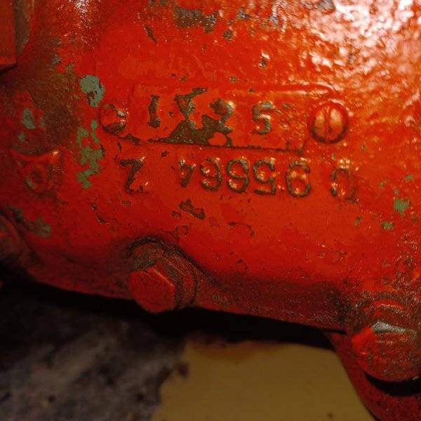

I need help identifying a Chrysler manual Tranny.
It's on the back of a 71 440 that I pulled out of a 74 Road Runner rust bucket.
I've never taken it off the back of the engine.
Are the numbers in the photo a clue to what I have, or are there other identifying markings elsewhere on the tranny?
Any and all help appreciated. I'm back in the Chrysler camp after many years playing with AMC cars. In my learning curve now.
The top #'s look like a date code. It ends with a 5. I can't say for sure what the other numbers are, but assume 1965. Let's see the whole thing and count the splines on the input shaft, etc. Does it have a pad with stamped numbers and letters on the other side.
