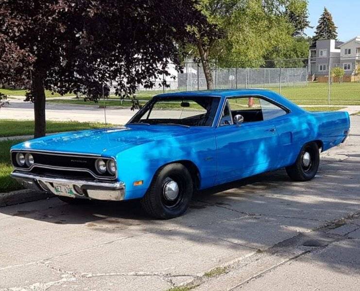

Thanks Wietse. It's a 1970 Plymouth Satellite which was an original 318/904 car, but is now a 440/727 car. I marked the throttle pressure lever on the trans at fully open, and then had the wife full throttle the carb, and adjusted the linkage so that both were at fully open at the same time, with neither binding on each other, if that makes sense.
Nice ride!
