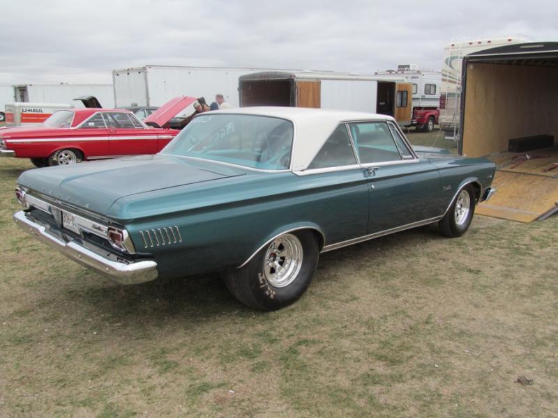

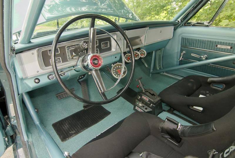

I'm finally going to install a trans brake in my '65. After talking to several racers it seems like the Biondo Terminator is the way to go due to its adjustability. However it is quite large. Has anyone mounted one in the SCS command center? or is there a smaller trans brake button out there that is just as adjustable as the Terminator?
http://www.biondoracing.com/product/TERM.html
thank you in advance.

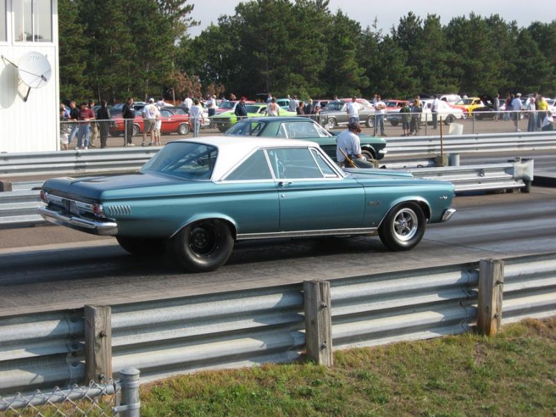

Can't help you out with your button, I'm just a foot braker. Looks good, your car is beautiful 65 Ply!
