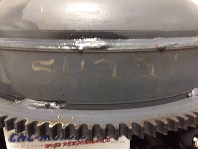

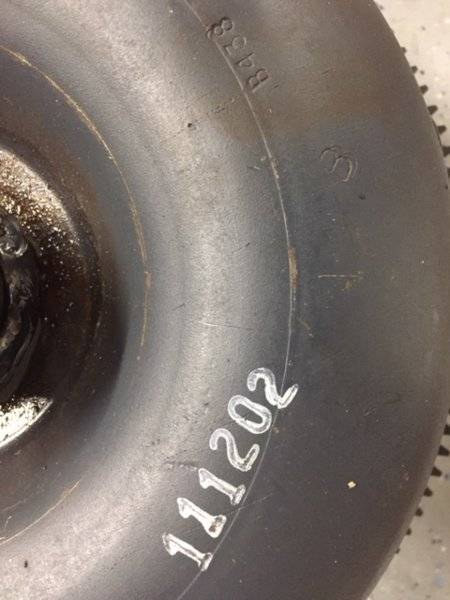

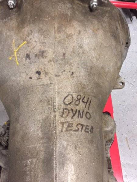

I am building a 520 stroker for my 66 satellite and was told when i bought the car that it had a new HD transmission with around 500 miles on it. As I bought it from the widow of the PO and it has sat in his garage since 2007 I am not sure exactly what trans setup I am dealing with and whether it will work with the rebuilt motor. Its probably a long shot but is anyone can help identify the parts I have from the pictures below it would be appreciated:
put some atf+4 in it and run it
you might get lucky
if not you'll know which way to jump
I could reverse engineer the valve body and see what was done but why bother
If you get flow in park it has a shift kit- if it does not- you don't
if it does you can see if it has "back to low"
best start off carefully in case it has a reverse pattern "manual" valve body
if it does then you know it was built-- no idea by who I guess
2007- may be out of warranty :)
me- I have a "lifetime" warranty
Thanks, sounds like a plan! I took the pan off and everything looks shiny & new which is a good sign but as you said - no warranty implied or given!! The converter is a mystery and we will see how HD the transmission is when i put the engine back in.
