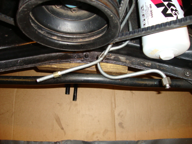

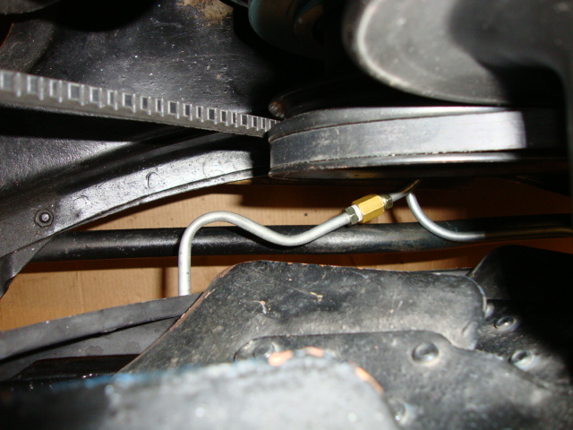

Here it is...the before (with rubber) and the after (with steel). I feel lot more confident with the steel...
thanks for all your response gents!!!
I hard line everything. Good call and looks good too!
