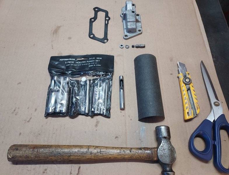

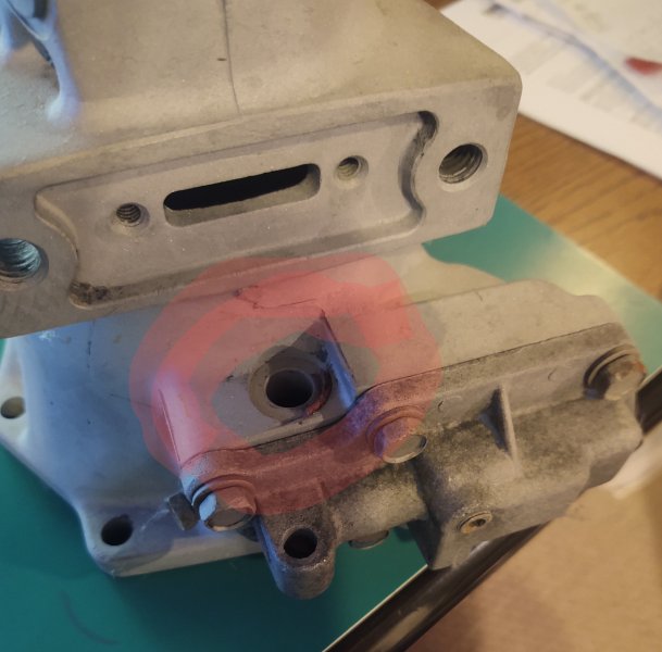

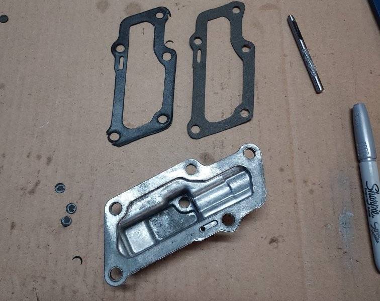

I made my own gasket from gasket material, hollow punches, razor blade.
The factory gasket is pretty thin. The housings aren't perfectly flat either. I make my own gaskets from .060 Felpro blue paper. Add a new o-ring on the cable. Also heat shrink with glue over the cable crimp.

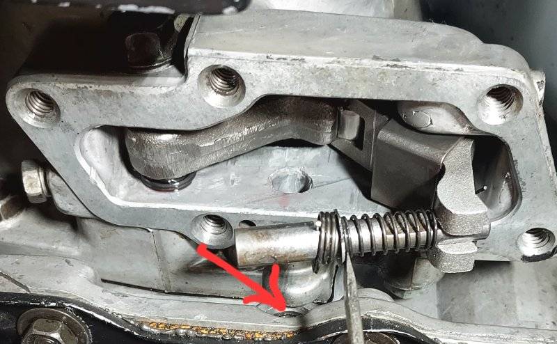

I don't believe the early 727 with the rear pump had that like the newer trans.
They absolutely do.... The early 904 captured it inside the tailhousing but the 727's leak there, just sealed one up a few months ago... After he'd replaced everything around it....
when I hear of a trans leak nowadays, I just figure someone botched the surgery
So this bolt serves double duty as a tail shaft housing bolt and a rear band anchor pin? Has a O-ring on it? Can you remove it without removing the pan and valve body?
