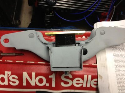

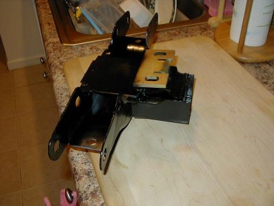

Ok, new problem. Does this trans mount look to high? I looks like the trans is hitting the fire wall with this in. It says tall on the description. PST 5.1112G
Does that mean there in one that is not "tall"
Pic's

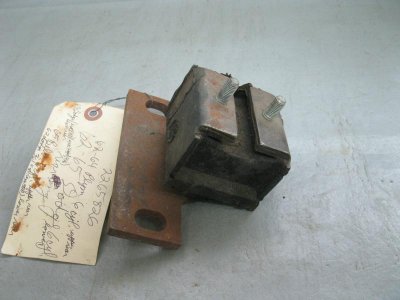

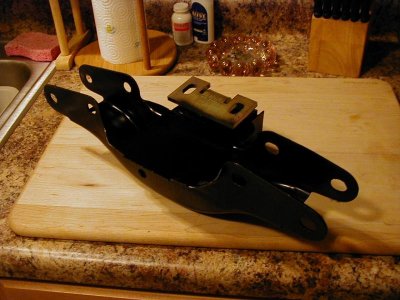

Ok, here is a Picture of an NOS Which is like the one that came off my car and a picture of the 5.1112G which I tried. The holes on mounting brackes that bolt to the trans do not look like they would match up. This could explain why mine was off 1/2" Anyone else us one of the new style?

Shumacher creative services, engine-swaps.com will have the correct mount, give them a call.
I just ordered one from them about 3 minutes ago. Looks Like the one I needed so I bought it. Tahnks For the reply.....TMEB 62-65 B-body

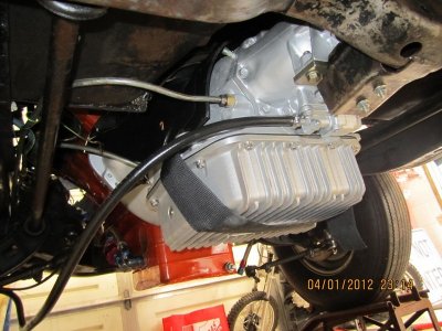

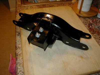

This is the one I got from them for a 63 Dodge with a later trans..

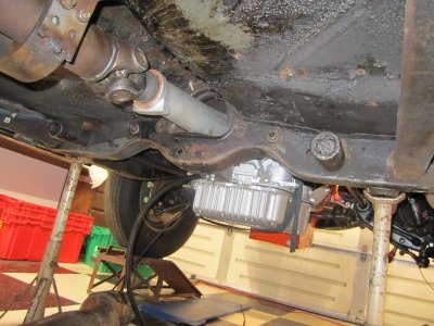

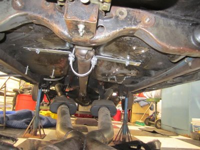

Looks like mine in a 63 plymouth:grin:

Gee, ya think they could be the same???:eusa_think:
