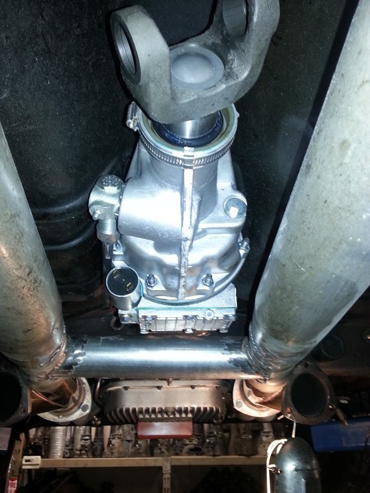

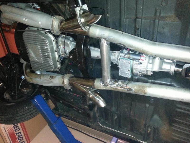

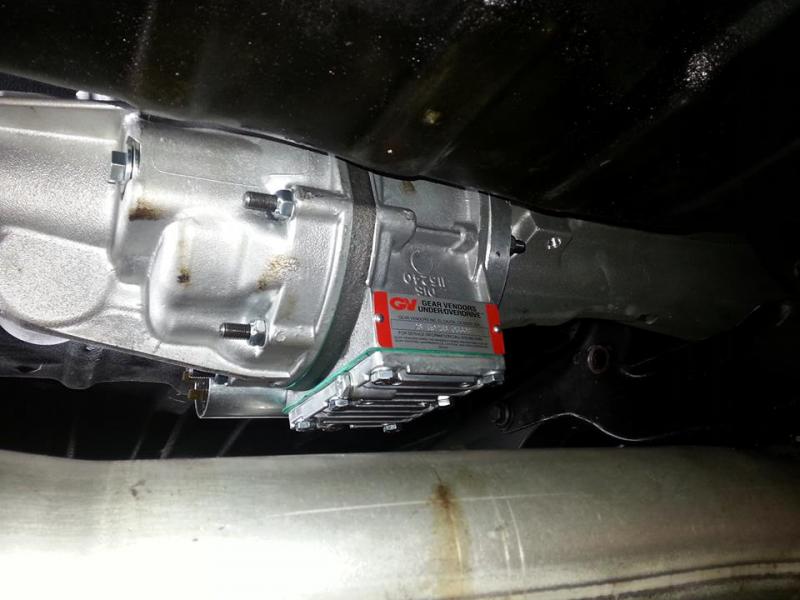

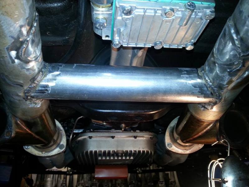

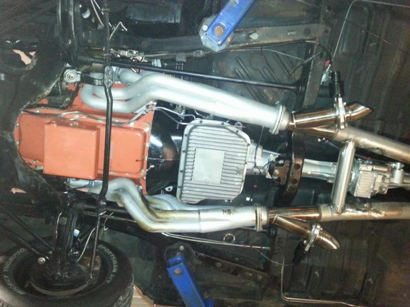

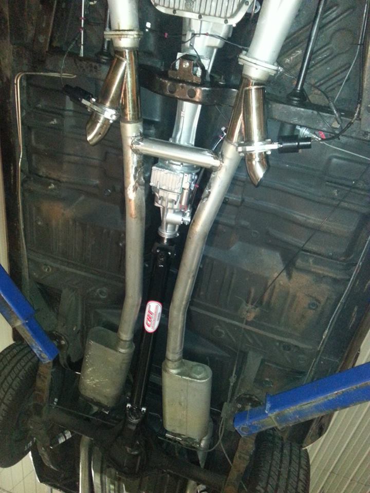

Here you go, the 727 w/GV. If you have an H-pipe, it needs to be moved further forward
Hey thanks, that is an awesome setup!
I like the cutouts too, had mine open quite a few times last night... LOL!
