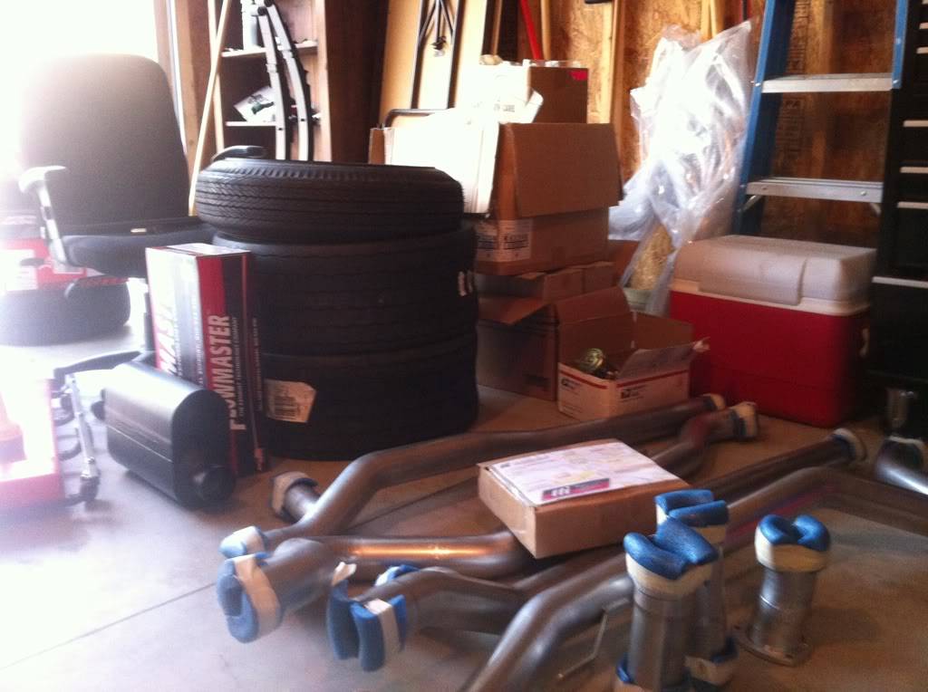

All the parts are here. Now I just need to start getting them on'er. I'll keep this thread updated with pics.
Nice stuff! I'm looking forward to seeing it all go on.

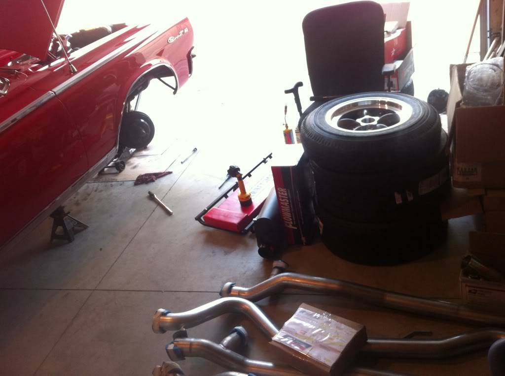

Got the Torq Thrusts and Firestone Deluxe Champions on!
2" Headers, RobbMC starter, and 3" exhaust go on tomorrow with the rear leafs to follow.
Now I just need the rear rims (steelies) to complete it.

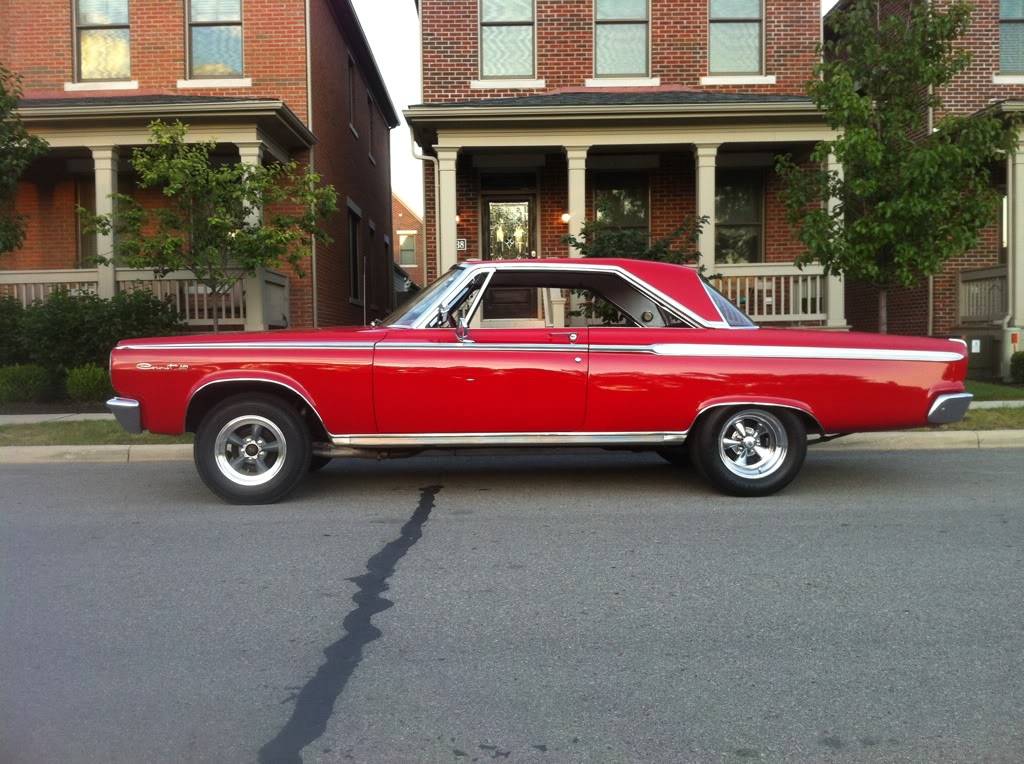

Before:

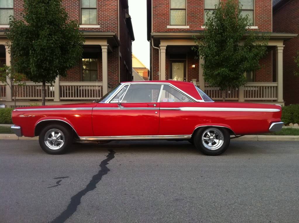

After:
Before or after that is a sweet car there Mike! Good luck with the rest.

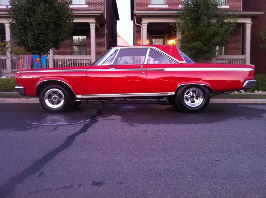

Looks like you screwed the torsion bar bolts up a little when you put the front wheels and tires on. If you are planning to race the car be careful with how much you raise the front of the car. You may want to look at this thread. That is just an exerpt from the entire article that has more info on where the front of the car should be.

i really like that 65! early b's are my favorites. what are you doing for an engine?
mike front end is too high. you need to lower torsion bar s down around 9-10 full turns down. your front end alignment will suffer and be off imo.
Since I've taken this picture I've lowered the fender wheel lip from 29.5" to 28.5". The SS springs are going on Monday afternoon with the 276x60x15 M&H drag radial. What is the appropriate wheel lip distance?
