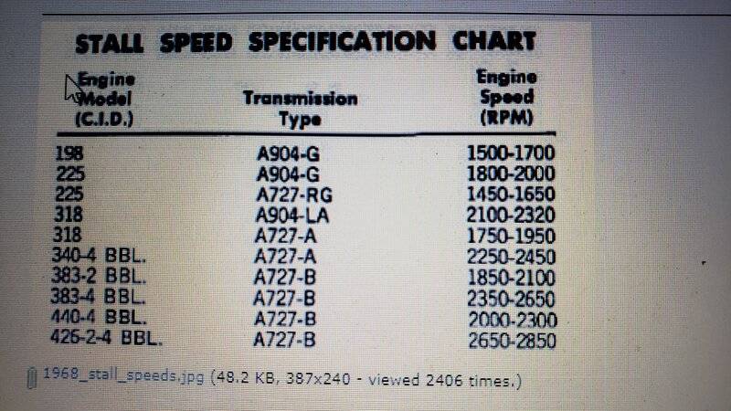

Can anyone advise whats the stock RPM is for the converter in a 727 tranny its a a 69 charger RT 440 engine
Stall speed? I would speculate around 1800 rpm +/-. It’s not going to be a precise figure in actual service although there may be a Chrysler table of rated stall speeds somewhere.
