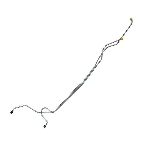

Bought transmission cooling lines from Inline Tube. Nice quality but I guess to save on shipping they bend them to make them shorter to fit in the box and place tags on the lines that say 'bend here'.
So I straightened out the lines, as per the tags, but they don't seem to fit properly, just off slightly.
As I don't have the originals to use as a template, if anyone has some pics of the proper routing I'd appreciate the help.

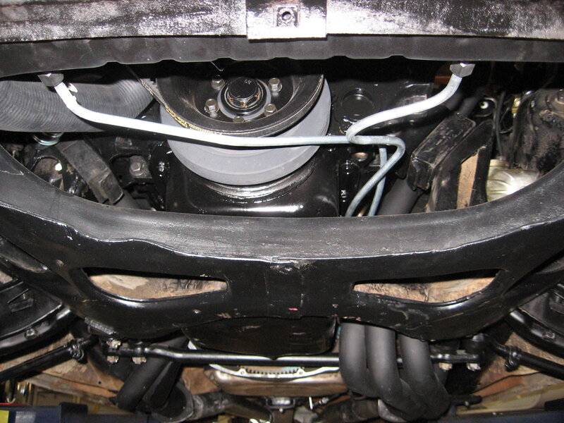

No full photos but they will take some tweeking and manipulation to get them in.I used the same brand.

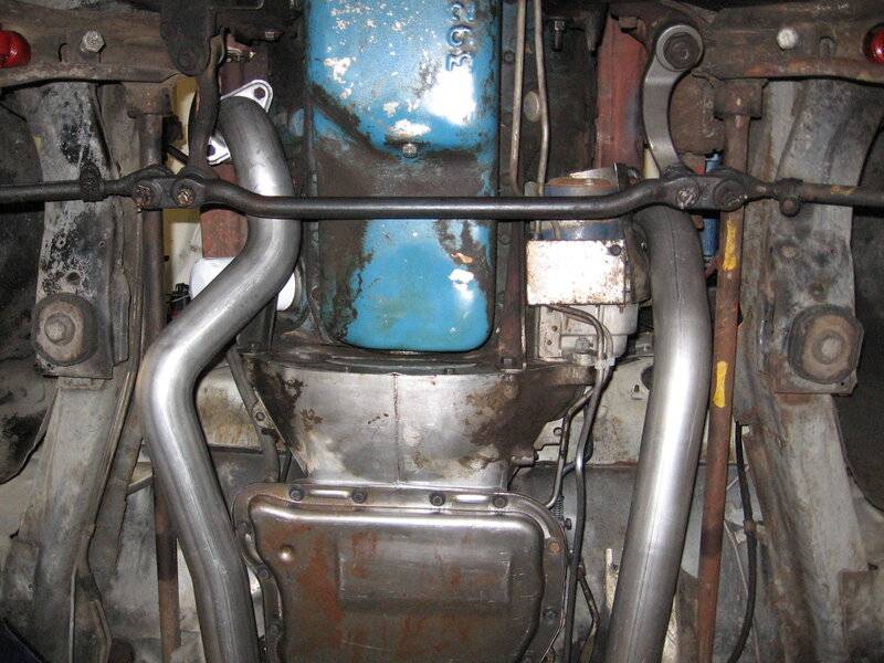

This is the O.E. lines from my 64 727 Poly
Hope this helps
Start at the rear and work to the front.

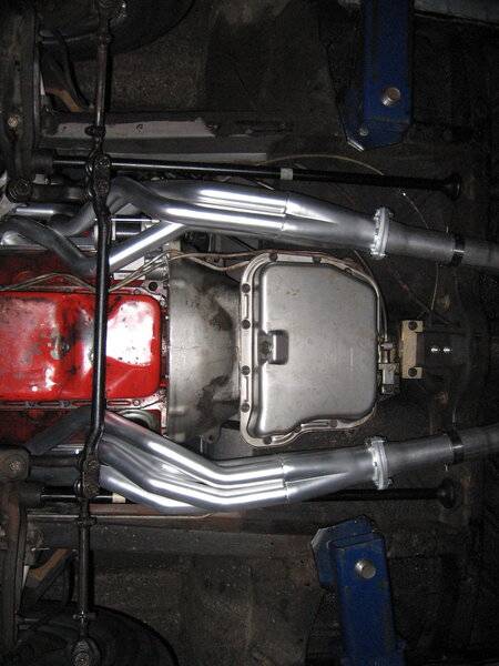

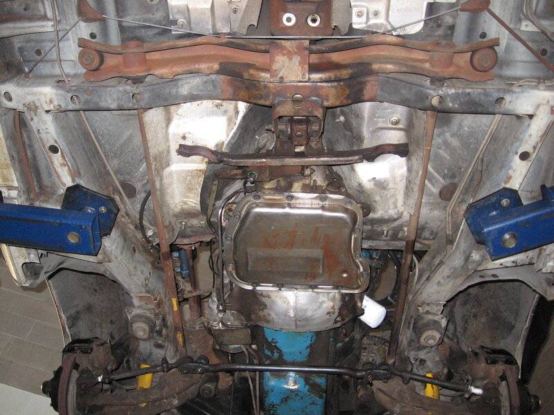

Another photo of a 727 in a later model B body
That steel spaghetti never fits exactly. Most of the time it is just a minor tweek here and there.
