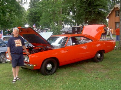

Thank you Very!! much for the help. Hope to have this completed by next week. One more question....in referance to changing out the rear end oil, can you ren me thropugh the process?
Sure. There is no drain plug so you will have to suck out the fluid through the fill hole. I have a second gear oil pump that I only use for old fluid. Same fill level check procedure - just below the bottom of the hole.
Oh yeah, nice RR by the way! Mine is R4 red too.
