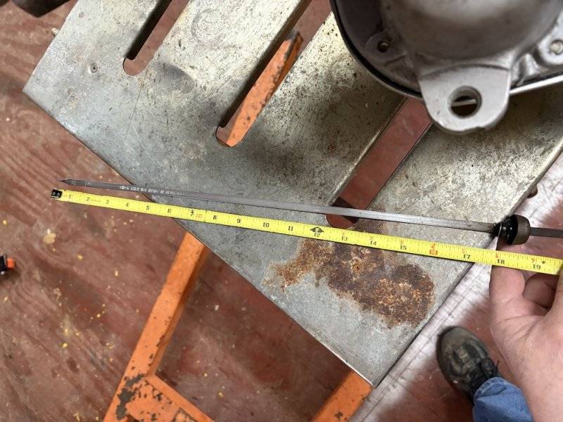

How long should the transmission dip stick be for a 66 dodge charger automatic with 318?

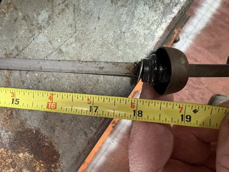

Thanks, but that doesn't really answer my question. My dipstick has a bolt attached to the end, welded or something. I have always filled the fluid to the fill line but get fluid leaking on the ground. It has occurred to me that maybe it is the wrong length dip stick and maybe i am over filling it causing the leak. That's why I want the length. The tube is still attached.
TIA
Just happen to have a 727 hanging in the air...
