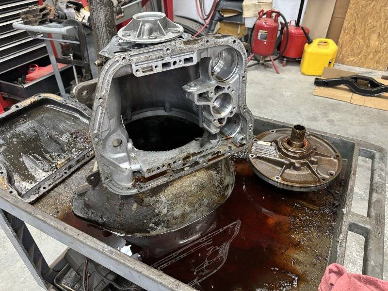

Transmission disassembly mess containment- show us yours!

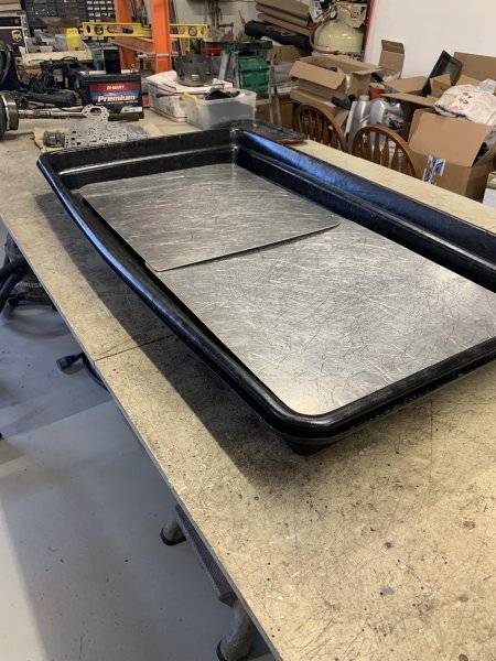

I found this 2’ x 4’ spill containment pan 3 or 4 years ago, put aluminum sheet in the bottom of it, all the old fluid collects down in the ribs below the sheets containing the messy part. Works great, I also use the pan any time I am dealing with radiators etc put it on the floor to catch the coolant I hate that **** dripping on the floor.
